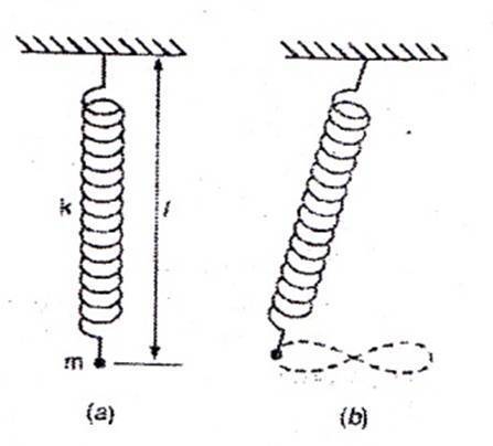

A mass ##m## on the end of a light spring of force constant ##k## stretches the spring to a length ##l## when at rest. The mass is now set into motion so it executes up and down vibrations while swinging back and forth as a pendulum. The mass moves in a figure-eight pattern in a vertical plane, as shown in the figure. Find the force constant in terms of ##m##,##l## and ##g##.
(Ans: k=4mg/l )
I noticed that the curve traced by the hanging mass is of the form ##r^2=a\cos(2\theta)## with the mass ##m## being at the origin at ##t=0##. But I don't think this is going to help. This is a question from one of my practice sheets and I doubt I need to deal with polar curves which aren't generally taught in high school.
How do I approach this problem? :confused:
Any help is appreciated. Thanks!

Since it traces out a figure eight that would suggest that one oscillation is twice what the other oscillation is so maybe you can factor that into your solution.
Likes 1 person
Lets me think of Lissajous figures. For a figure 8 the frequencies of oscillations are 1:2. In this case the up-down oscillations are twice those of the pendulum motion. Not sure this helps or is relevant though.
Likes 1 person
Ah yes, thanks a lot jedishrfu! :)
$$2\times 2\pi\sqrt{\frac{m}{k}}=2\pi\sqrt{\frac{l}{g}}$$
$$\Rightarrow k=\frac{4mg}{l}$$
I think the springs' frequency of oscillations is twice that of the pendulum in this case.
