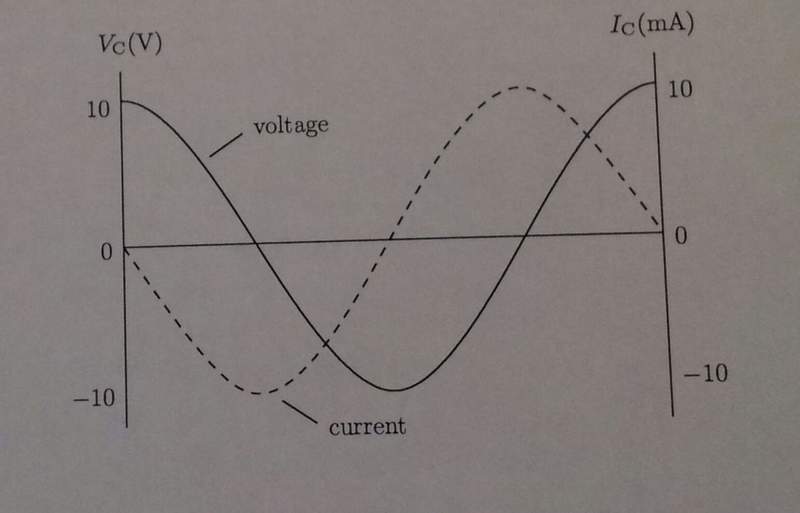

1. Current and voltage graphs are shown for a capacitor circuit with ƒ=1000Hz.
What is the capacitive reactance Xc?
2. I know the equation is Xc= 1/2∏ƒC to solve for capacitive reactance but where do I find C? All of our in class examples had C and ƒ given.
That formula is not correct. You need a pair of brackets to set it right or you'll never get the right answer!
What would be the equation for current if you connect that capacitance C to an AC voltage source V volts?
Get the reactance from the graph.
What are peak voltage & peak current?
The only other thing I can think to do is rearrange ΔVc= I*Xc
Xc= ΔVc/I
Xc= 10V/10x10^-2 A which gives me 100Ω
Xc= ΔVc/I
10V looks right for the voltage. But that's not the right way to write 10mA.
