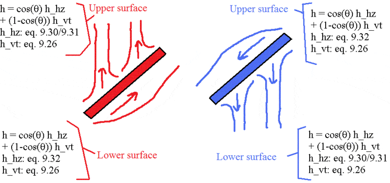

Okay, back on the laptop here and I can address this using a little bit more detail.
So, one way to APPROXIMATE (this is not physically realistic, but it won't make you end up too far off), is to use a weighting function that interpolates between the results you get for cases you know (100% vertical or 100% horizontal). This becomes increasing complicated because the upper and lower surface behave differently in terms of free convection, so you actually have to calculate 3 Nusselt numbers (with three different Raleigh numbers because they use different characteristic lengths I think). You then use your three Nusselt numbers to get your three convection coefficients, and then can use the averaging shown in the figure.
Again, this is likely non-physical, but you're going to have issues anyway as far as I can tell, because wind direction is going to change the boundary layer (theoretically) and therefore change your convection coefficients. Incropera and Dewitt give instructions for combining free and forced convection, but in your case they'll likely be non-physical anyway because the way the wind flows across the surface will change depending on your collector's orientation.
Theta in the figure is the inclination angle from horizontal, in case you needed to know (0 = horizontal, 90 = vertical).
