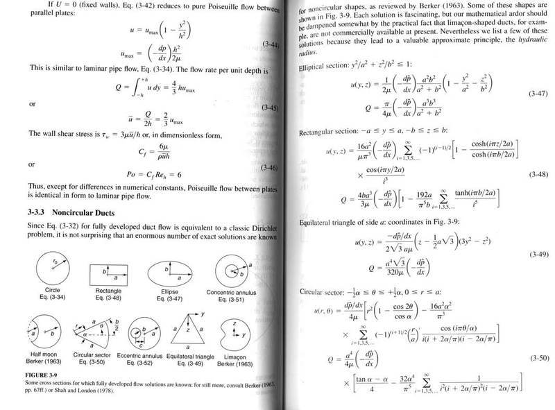

This is the culmination. I gave you a way of calculating the Reynolds number in my first thread. The velocity is an OUTCOME of an external force, so that the Reynolds number is intrinsically defined even if you don't know the solution. That's the task of an engineer and you should know it. To guess the unknown variable estimating it by using the flow equations (NAVIER STOKES EQUATIONS).
I'm going to finish with you saying something. I appreciate your experience and your background, and I am pretty sure that you have developed an excellent job. But don't cover your ears never when hearing something that does not fit with your stuff, despites how old are you.
Now I will answer Fred:
[quote=Fred] I have not seen the energy equation being restricted to fully turbulent flow. The only restrictions I have seen are fully developed, steady state, incompressible.
[/quote]
My questions are:
Given this equation (the Bernouilli corrected or whatever Crane calls it):
[tex]P_1+ \rho g z_1+ \rho \frac{U_1^2}{2}=\lambda L \rho \frac{U_1^2}{2D}+P_2+ \rho g z_2+ \rho \frac{U_2^2}{2}[/tex]
or the similar version you use, that is coming from a differential version:
First:
How are you integrating for obtaining U_1 and U_2 constants when the profiles are not constants? (recall Poseuille profile in viscous flow)
Second and much more important:
How do you know that the energy dissipated on the RHS is proportional to the Kinetic Energy?.
The answer to both of them is that it does not make sense to use it in a Low Re flow. On the other hand, we do know that energy dissipation is proportional to the kinetic energy of the large scales in the bulk of a turbulent flow. As we approach to the wall, the small scales are dominant and the roughness of the wall starts to be of the order of the viscous length. There the energy dissipation is proportional to the viscous stresses, but such contribution is of second order in a fully turbulent flow.

OK, back on topic, I guess I will try to end the fighting. I have an 'exact' solution to the problem, so I WIN! I'm surprised no one else has seen this, its out of a book called "Viscous Fluid Flow" by White (2006) in a chapter titled Exact Solutions. He references Berker (1968?) for these exact solutions to combined Couette-Posieulle Flows through non-circular ducts.
I was going to type it out, but decided it would just be easier to scan the pages instead, that way you not only can see the solutions, but there are several other interesting equations on the page.
Enjoy

Hi Minger,
Thanks for posting your reference. I'm afraid it's not an exact solution to the flow problem, it's only an exact solution to the hydraulic diameter. In this case, it might be a bit more work than some people are interested into determine Dh to that degree of accuracy though. Have you tried calculating the flow rate for this?

Q_Goest said:
Hi Minger,
Now it's my turn to talk and to tell you that once again you show a narrow knowledge about the Basics. I will leave to use the calculators to the practising engineers. In the meanwhile I'll be talking about physics. Minger is right, the solution he posted is an exact solution for viscous flow, in the sense that the velocity field obtained there represents the exact distribution of velocity you would measure with PIV on each section of the pipe (or tube). It says:
Since eq 3-32 for fully developed duct flow is equivalent to a classic Dirichlet problem, it is not surprising that an enormous numbers of exact solutions are known.
Do you know what is a Dirichlet problem? I will refresh your memory. For sufficiently small Re, the viscous forces are balanced with pressure forces:
<br /> \nabla P=\mu \nabla ^2 \mathbf{u}<br />
The Poseuille flow assumption reduces the problem to the streamwise coordinate:
<br /> \frac{\partial P}{\partial x}=\mu\nabla^2 u <br /> (1)
where u is the streamwise velocity, P the pressure, \mu the dynamic viscosity and \nabla^2 the Laplacian operator. This equation is complemented with a non slip boundary condition:
u=0 on the wall. (2)
Therefore, (1) and (2) represents a Dirichlet problem, and the solutions you are seeing in Minger's reference are the exact solutions of u(x,y) of that problem (a reference which by the way is a respected one as far as fluid dynamic scientists are concerned). There is no approximation of any hidraulic diameter or similar. <br /> <br /> <blockquote data-attributes="" data-quote="" data-source="" class="bbCodeBlock bbCodeBlock--expandable bbCodeBlock--quote js-expandWatch"> <div class="bbCodeBlock-content"> <div class="bbCodeBlock-expandContent js-expandContent "> I think you&#039;ve touched on one of the problems there. One problem I had when getting out of college and having to do pipe flow, was the lack of preparation in many practical aspects of engineering. College is generally focused on this academic ideal where we learn about such things as viscous shear and how to set up differential equations that almost invariably can&#039;t be solved. This as opposed to teaching how to determine pressure drop through elbows, miter bends, valves and the like. I bet the vast majority of students don&#039;t even know what Cv for a valve is, let alone how to calculate pressure drop given this flow coefficient. </div> </div> </blockquote><br /> I hope you are not meaning that I don&#039;t know what it is. What I do know, in words of important professors of academia in U.S. of Aerospace Engineering, is that the education that US universities are giving to undergrads is a poor one, in the sense that as time goes by they get out knowing less things. Don&#039;t forget that my undergrad education is from Spain, more over I am not a B.S. Engineer, I am an Ingeniero Superior or Ingenieur which corresponds to a M.S. here and now a M.S. in Europe. <br /> <br /> I don&#039;t know if Fred and you are trying to diminish what we do in Science (I was an student when I was an undergrad, now they are paying me for doing Science). I will let you know that here we are a bunch of engineers, we are given projects with fundings of amounts of order $500K, and we have to manage to take the project to a final solution not only having to make the funders happy, but also doing new Science for the world. And we do what is needed to arrive to a solution. People they work in Labs, another work in Computation, and some others work in Theory. And be sure that the current status of the Science does not allow you to pursue ideal dreams far from real applications, because they become unpublishable. So as you may realize, the thing is not so naive, even though we make less money by far than a practising engineer.<br /> <br /> I have been writing here since 3 or 4 years (i don&#039;t remember exactly). I consider I have been wrong sometimes and right anothers. I really think I have given a valuable contribution to various forums of PF, and so the mentors have recognized it. If you and those who meant it, keep on teasing the academia or those who don&#039;t dedicate their lives to such honour of being a practising engineer ( so far), then I would have to leave this forum and every writer here will obtain help when calculating pressure drops, but some other questions pertaining to fluid dynamics science will remain unanswered collaborating to a professionalization of this forum and not leaving any place to fundamental questions of students and non students.

Minger is right, the solution he posted is an exact solution for viscous flow, in the sense that the velocity field obtained there represents the exact distribution of velocity …
Yes, you're correct. I read through it too quickly - thought it was a calculation for determining Dh. My mistake.
Next step is to show how the equation can be resolved for some given example. How about the 1 mm square tube? Can you calculate the flow rate using this equation? I'd honestly like to see how that can be done, and no I'm not being facetious about that. I've provided in some detail how I've calculated the flow rate for the example provided, and even did the calculation. I've also done it using more sophisticated software, and found the same answer. Note that the software I used also uses the same methodology as I've provided here, it doesn't use the equation provided by Minger, and it doesn't use Navier Stokes equations. So I'd like to see how you propose this is supposed to be done. You haven't explained it yet!

Q_Goest said:
What I see is a fundamental limitation for obtaining real solutions to practical problems using the more theoretical approaches you've suggested. In fact, without doing CFD analysis, I honestly don't know how one could realistically do a flow analysis on any simple piping system using the approch you're suggesting. And if someone has to resort to a CFD analysis to do a piping run, the entire engineering community is in serious trouble.
Sure that using what Minger gave is a little bit out of scope for this problem. But integrating given a pressure loss, integrating the u(x,y) formulas there on a differential element of pipe section dS=dxdy gives you the EXACT mass flow. Your approach is an APPROXIMATE one. Possibly a good one though.
It is worthy to use what Minger gave instead the engineering method?. Possibly it is not worthy for an engineering calculation. (keep on reading, please).
There is a lot you don't understand about flow through piping systems, that much is obvious. The standard methodology for analyzing pipe flow throughout the industry is something you haven't learned yet because it's not generally taught in college. Furthermore, you're obviously holding a grudge against everyone that uses this methodology. Why I'm not quite sure.
Sure there is a lot of particular stuff concerning engineering methods that I don't know (underline this). That's damn right!. Maybe here there is a misunderstanding. The misunderstanding is that what you think is Basics I think is Application and what I think is Basics you think I don't know what. With Basics I mean the Basic laws of Fluid Mechanics, in its differential forms and integral forms and the Theory supported by experiments that holds them. Upon them lyes all the physics of this Science. With all my respect, you know a lot about engineering methods (applications) but you don't know anything about those basics laws. Therefore you are practically blind and driven by your software and the three or four equations that you know (DW and Bernouilli and a couple more).
Maybe this is not the case and the OP wants a quick response using engineering methods, but what I will not allow while I'll be writting here is that many students reading these thread get encouraged by you to forget about those basic physics concepts and jump directly to your engineering methods. That's not the way one ends up knowing a little bit of this, and that's not the way to show the power of this field to the rest of the science disciplines.

I actually needed to do the same calculation for my research and came across this thread. Very helpful information from the person who posted the "exact solution" from the text. Now
P2 - P1 = Q * R
I did the calculation from the textbook equation 3-48 for the square tube case and solved for the R. Here's the resutling equation
P2 - P1 = Q * 1.7784 (l*u/a^4)
where l is the length of your tube, a is the width of your channel divided by 2, and u is the dynamic viscosity of your fluid. Plug in your flow rate (volume/time) and you have your pressure drop.
Enjoy. This equation only applies for laminar flow, so do your Reynold's # calculation first.
