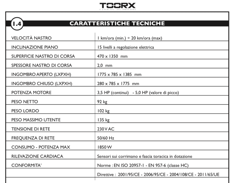

Can someone help me? Is there a way to use my European treadmill (3,5HP, 230V AC, 50/60Hz, 1850 WATT) here in US using a transformer/converter? thank you!

Thank you all. Unfortunately it is already in the US, and I understand that it is very very complicated, also because I should ask an electrician who knows both European and American standards. About the HP and Watts, I attach the manual information about that.

The problem is that at full speed and maybe even right when you turn it on, it will likely trip your circuit breaker. 1850W is just above the limit, but if it draws like a 3.5 HP at startup, that's 2900W.
Or worse if that doesn't account for efficiency and power factor.

So, you also think that with this I can use my treadmill from a 110V outlet?

20A circuit, yes. 15A circuit, maybe not, not if it draws full power. Try to avoid a 20A circuit that has other significant loads at the same time (microwaves, hair driers, etc) or you may trip the circuit breaker.
