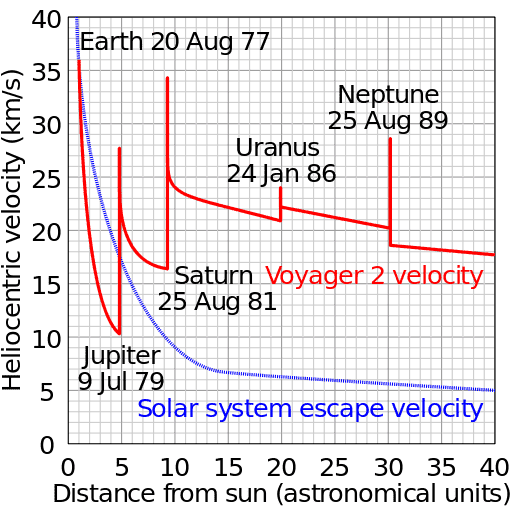

The cosmic velocities are dependent on position in the gravity well. The 42 km/s is the escape velocity in the Sun's gravity well at the distance of Earth's orbit. It's much lower where the Voyagers are currently.
There's a nice graph of Voyager 2's velocity vs escape velocity on its Wikipedia page:
The spikes are flyby manoeuvres.
