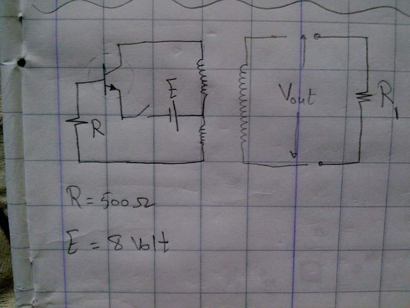

i ve reached a devise that convert the dc into ac ,,it depend on the unstable of transistor as beta changes so ic and ib changes making flux variation in the transformer coils(12v\220v) and produce ac voltage in the other terminal,,,, but the problem is when i measure Vout with R1=infinty it give value of 150 volt and when i change the value of R1 the voltage change with it directly .. how can i make the voltage constant what ever resistance i put?
You can't.
If you think you can, you shouldn't be working on 120V circuits. Instead, learn about electronics with lower voltage circuits first. It's a simple matter of your own safety.
Redbelly98 said:
You can't.
why??!would u please explain
Using an isolated Flyback converter (or two) you could satisfy the constraints of "increasing a dc voltage by 'using' a transformer".
You'll have to increase the power capability of your DC source on the primary so that it can handle the load on the secondary.
Power is finite in this circuit. Let's say that your DC source can supply 100mW of power, and for simplicity, we'll assume a lossless transformer
P = V * I -> P/V = I
0.1 / 150 = 667 uA
So if your DC source can supply 100mW of power, the most current you could draw on your secondary would be 667 micro-amps to sustain 150V
V = I * R -> R = V/I
150 / 667^-6 = 224887 ~ 224k
So your biggest load would have to be equal to or greater than 224k. If you increased the load beyond that (lowered the resistance so that current increased), your voltage level would drop. For example, assume a 100k load.
150 / 100k = 1.5 mA
P = V * I -> V = P/I
In this example, we have said the max power your source can supply is 100 mA, so:
V = 0.1 / 1.5^-3 = 66.7V
As you can see, you have exceeded the max power of your source, and your voltage levels took a hit and fell from 150V to 66V.
To make this simpler, check your load and see how much power it consumes. If you're plugging in a TV or a space heater, see how many Watts it consumes and then make sure your DC source on the primary can supply that many Watts.

Every voltage supply has a maximum output current. If you choose R small enough so that Vout/R is larger than that maximum current, the output voltage must drop to a lower value.

im using for 9 volt source an (9volt battry panasonic)...i will not connect spceific thing just test the output on variable resistance to see the output power,, i just want to built that devise for knowlage and experince ,, and later i can connect it to some devise which need high input voltage..
