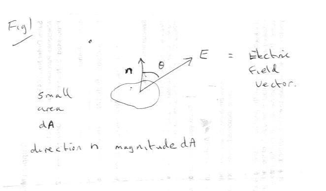

If we now offer up our small hoop of area as I decribed in post#3 we can sum all these little arrows.
Formally we do this by regarding the area as another vector, described by a vector, dA, whose direction is given by the unit normal to the centre of this area, the vector n.
We then form the scalar product of the dA vector and the E vector (which points in some different direction).
Note I have considered a small (differential area).
As in Fig1
E.dA = E dA cos(θ)
This is called the flux through the area.
If we sum this over a large area we integrate to find ∫E.dA = ∫E dA cos(θ)
We call this the total flux through a large area.
