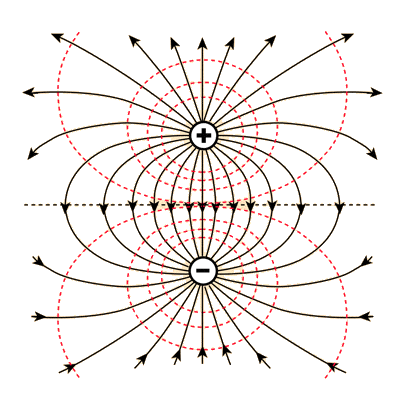

See: http://hyperphysics.phy-astr.gsu.edu/hbase/electric/equipot.html
Here you see two electrodes - one positive and one negative.
The dotted red lines are the equipotentials that you were drawing (starting to draw).
You got the circle around the (+) and the mirror line, but see how the negative is different to yours?
The black lines are electric field - see how they relate to the equi-potentials?
