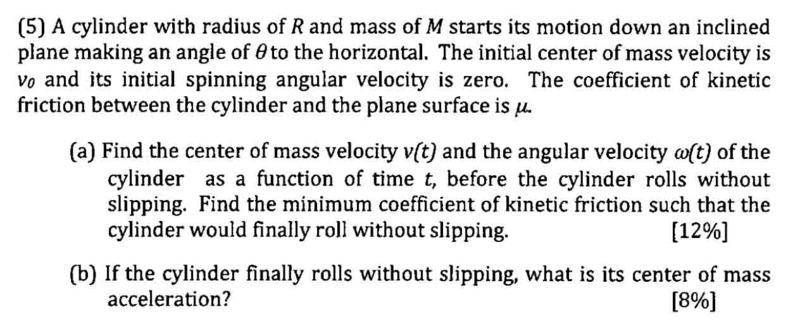

See the attachment Q5
Let's begin with part (a) first.
After finishing this homework (see the second attachment), I suddenly noticed 1 thing. The friction will gradually decrease to zero and then change the direction to become same as the motion direction.
Therefore, my work on part (a) would be wrong. Since I assume the friction is a constant (mgμsinθ).
How do I fix it?
And also, is my way to find the minimum coeff of kinetic friction correct?
And for part (b), it is really that easy?
  • Typed homework problem 5 about a cylinder of radius R and mass M sliding down an inclined plane at angle θ, with initial center-of-mass velocity v0 and zero initial spin; parts (a) and (b) ask for v(t), ω(t), a minimum kinetic friction coefficient μ, and the acceleration after rolling begins.

For part (a), make sure you use the correct trig functions when finding the components of the weight. Otherwise, looks good!
For part (b), the friction is no longer kinetic friction when rolling without slipping.

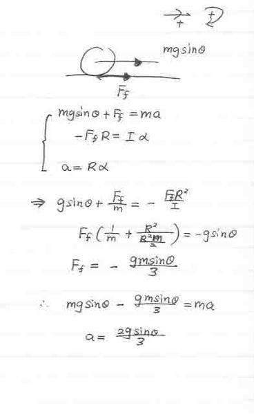

Part (a) looks good except for finding the correct expressions for the components of mg along the slope and perpendicular to the slope.
For part (b), you do not need a coefficient of friction. Just consider the torque and force equations and link them using the relation between linear and angular acceleration for rolling without slipping.
Oh, I found that the direction of the friction turns out to be to the left. Does it make sense?
  • Handwritten derivation for a cylinder rolling down an incline: a circle with rightward arrow mg sin θ and leftward friction Ff, equations mg sin θ + Ff = ma, −Ff R = Iα, a = Rα, leading to Ff = −(2/3)mg sin θ and a = (2/3)g sin θ.
Before rolling, the cylinder shifts downward so the kinetic friction acts in the opposite direction, upward along the slope. With that direction, friction accelerates rotation and decelerates translation.
ehild
Yes. There has to be a clockwise torque about the CM in order to give a clockwise angular acceleration as the cylinder accelerates down the slope.
