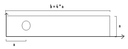

Given a homogenous rectangular surface, sides of length a and b=4*a, with a circular hole in x=a and y=a/2, find the center of mass.
Diagram of a long rectangle with a small circle near its left end; the total length is labelled b = 4 * a, the height is labelled a, and the circle sits at a distance a from the left edge.
R=1/M*Ʃmi*ri , M= total mass, r= position vector
area of a circle = pi*r2 , r being the radius
I determined the center of mass of the surface and circle and tried to subtract one from another, however the result did not agree with the solutions.
Acircle=pi*r2 = pi*a2/4
Arectangle= a*4a = 4a2
Center of mass of the rectangle alone:
Rr=(2a,a/2)
Center of mass of the circle alone:
Rc=(a,a/2)
R=[Rr*Arectangle - Rc*Acircle] / Total area ⇔
⇔R=a*(32-pi)/(16+pi)
The correct center of mass is (2,05,a/2)
Thanks!
D.
You need to subtract the areas in the denominator because you're considering the circle to have negative mass. Right now, your calculation is for the solid slab plus a positive-mass circle located at (-a, -a/2).
Also, to get the answer you cited, I think you need a different radius for the circle. Is the radius of the circle really equal to a/2? If so, you won't get that answer.
