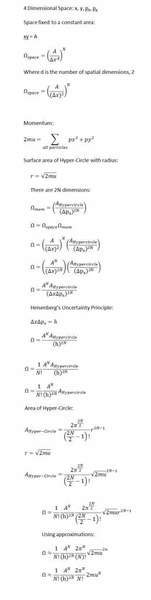

I have practically finished part a, with one small exception. for the pi fraction, I have 2pi instead of pi?
Some of my working out:
The space multiplicity:
[tex]\Omega_{space} = (\frac{A}{(\Delta x)^2})^N[/tex]
The multiplicity of momentum:
[tex]\Omega_{mom} = (\frac{A_{hypercircle}}{(\Delta p_x)})^{2N}[/tex]
[tex]\Omega_{mom} = (\frac{A_{hypercircle} ^{2N}}{(\Delta p_x^{2N})})[/tex]
The total multiplicity is the multiple:
[tex]\Omega = \Omega_{space}\Omega_{mom}[/tex]
[tex]\Omega = ((\frac{A}{(\Delta x)^2})^N )(\frac{A_{hypercircle} ^{2N}}{(\Delta p_x^{2N})} )[/tex]
This can be rearranged, and using Heisenberg's Uncertainty princeple, [tex]\Delta x \Delta p_x \approx h[/tex]
this gives:
[tex]\Omega = \frac{A^N A_{hypercircle}}{h^{2N}}[/tex]
For indistinguishable particles:
[tex]\Omega = \frac{1}{N!}\frac{A^N}{h^{2N}}A_{hypercircle}[/tex]
Area of hypercircle:
[tex]\frac{2\pi^N}{(N - 1)!}{\sqrt{2mu}^{2N-1}}[/tex]
and using approximations:
[tex]\Omega = \frac{1}{N!}\frac{A^N}{h^{2N}}\frac{2\pi^N}{N!}{2mu^N}[/tex]
As you can see, close, just that annoying 2...
Any ideas how to get rid of it?
Thanks in advanced,
TFM
I have attached the entre workings out. any idewa how to get rid iof that pesky 2...?
TFM

Sorry for 2 year late reply. You're probably graduated by now. But according to Schroeder's book, for part (a),
you can simply throw away the 2 because the multiplicity is very large compared to the 2, and thus it won't really make a difference. He then apologizes below for sloppy working. But... oh well that's what I just read.
