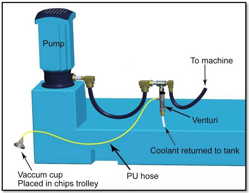

Hello,
We make a Venturi vacuum system for recovering CNC coolant from the swarf trolley. It is a simple arrangement consisting of a venturi tube tee'd off the coolant pump and a stand-off placed at the bottom of the swarf trolley with a filter disc.
Now the problem with this system is that it is dedicated to each machine, where pressurized coolant passes through the venturi from the pump (motive) and creates a suction through which coolant is sucked from the swarf trolley. Coolant that passes through the venturi is returned to the sump. A schematic is attached for reference.
Now, I have had multiple clients ask for a similar portable system. But I can't for the life of me figure out how! I could use compressed air or even a Turbine Blower to generate the vacuum in the venturi, but the sucked coolant will mix with this air on the outlet of the venturi. How do I avoid this?
Thanks,
KV
No doubt you've been thinking this through and I'm only here five minutes so forgive my 'obvious' suggestion. If the "to machine" feeds several machines and the yellow line is fed by all the vacuum cups then, as long as it's all balanced with appropriate valves to control all the different flows then coolant would be fed to and fed from all the machines.
It could be a lot quieter than a pneumatic system and no 'oily air' to get rid of.
Or did I just mis read the situation?

However it's done, it should not be necessary for the sharp bits of swarf to get into any pump. It's common to pass the dirty coolant through a trap first with a low entrance and high exit to the pump and let the heavy particles fall to the bottom. Graded filters can also remove various sized particles. Alternatively, if the coolant is relatively low viscosity, a centrifugal system can remove particles ('Dyson').

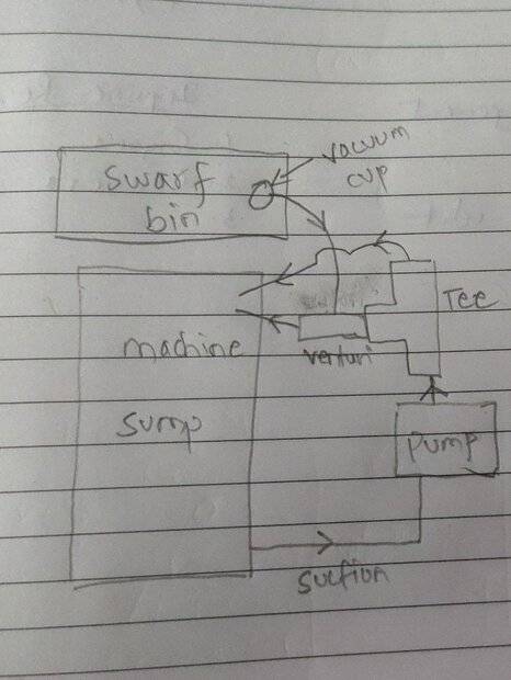

Sorry. I'll make it clearer. The diagram shows the coolant tank and plumbing of 'one' machine. The venturi is installed on the discharge end of the pump and the vacuum cup is placed in the swarf trolley of that particular machine. The 'To machine' is the hose that supplies coolant to the spindle of that machine. This is the basic arrangement i have now.
The requirement is to replicate this in a portable setup. The venturi needs coolant pressure to generate the vacuum. This coolant which passes through the venturi is returned to the tank through a pipe connected to the outlet of the venturi ('Coolant returned to tank' in the pic)
Maybe I can use a AODD pump in a portable trolley. Suction piping that will simply drop into the coolant sump, my venturi connected to the discharge end of the pump with a tee connection. Outlet of venturi will again have a pipe that is dropped into the sump (to return the coolant that is tee'd off). Finally the third port of the Tee will also have a pipe that returns coolant into the sump (three pipes enter the sump.. the suction pipe and two lines from the Tee.. pic enclosed for reference).
Is it too simplistic? Meaning.. it basically consists of a pump, venturi, tee and some pipes. Does it make sense as a buyer to get this as opposed to a dedicated system on each machine? As this portable one will require a guy to continuously drag the trolley around from one machine to the next, probably in each shift to recover the coolant from each respective swarf bin.

Also my present system uses zero resources to make it happen, as we simply use the coolant from the pump. No air or electricity is required.
The portable setup might require one of the two.

Sorry for the delay in response. But here's what I've done this week :-
Took a simple AODD pump and dropped its suction flexible pipe straight into the machine sump, discharge pipe from the pump connected to my Venturi, outlet of which is returned to the sump with another flexible pipe. Took trials and the system works!
Some queries :-
1. Used an AODD pump since no flooded suction can be provided (pump mounted higher than the tank). But this has led to a pulsating flow at the outlet of the venturi that goes back into the sump. Can this be turned into a continuous flow? Pulsation Dampener / Centrifugal pump perhaps?
2. We took this trial with only water. I am worried that the pulsating flow will cause some atomization of the coolant or maybe foaming might happen? Not sure.
Any tips?
Any help would be appreciated guys!
Questions :
1. Pulsating flow out of the venturi might lead to foaming or atomization of the coolant? Or not?
2. For cases with a suction lift of less than a meter, are AODD pumps advisable or can I work with a centrifugal pump as well (for coolants..). If I must use an AODD pump and in case pulsations are not desirable, I need a pulsation dampener. Please correct me if i am wrong here.
But then I would much rather use an AODD pump since I do not want to introduce any electrical connections to the trolley. A simple air line shall be used. So I guess, centrifugal pumps are out.
