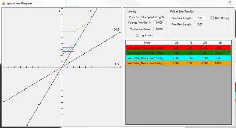

I appear to have a different take on this problem. As far as I am concerned, the circuit never closes either from the reference frame of the battery or the plate. It's an issue of relativity of simultaneity.
Here is a web page with pictures and real calculated numbers
http://www.relativitysimulation.com/Documents/BatteryParadox2.htm

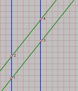

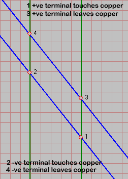

MikeLizzi, please point out my error, because these diagrams indicate ( to me ) that in the track frame, the -ve electrode touches the copper while the +ve electrode is in contact. The rest length of the battery is the same as the rest length of the copper. The relative velocity is 0.80c.
There seems little doubt that the resolution is by treating the copper as a capacitor and looking at the charge/discharge cycle in each frame. The transient current will produce an EM pulse in both frames - and I'll bet the pulses are related by an LT boost. The state of the system will return to its initial state when the battery has passed, and there's no reason to expect any paradox.

PeterDonis said:
I think everyone is in agreement on this. What's described on the page you linked to is basically what I described in posts #7 and #19, except that they are using a weird kind of clock synchronization. The issue appears to be more in the details of what would constitute the circuit closing, and what happens when a circuit is "partially closed" but not yet fully closed.
Oh, good. Sometimes I have trouble following (understanding) other peoples posts.
With regards to the graphics I referenced and clock synchronization;
In the scene, a reference frame is defined with origin at the center of the scene (call it S) at time t=0. Its velocity with respect to us, the observers is zero.
The plate is at rest with respect to S and at position +x. So the plate has no length contraction and all clocks attached to it display the same value.
The battery is moving to the right at .866c with respect to S at some distance –x. The battery has length contraction and clocks attached to the battery at different locations display different values (proper time). The clocks on the battery are running at half the rate of the clocks on the plate.
With regards to the meaning of “closed circuit” I would offer the definition that the circuit is closed when the following condition applies:
1. The plate is in contact with terminal t1 when the proper time for the clock on t1 displays tc
2. The plate is in contact with terminal t2 when the proper time for the clock on t2 displays tc
And that never happens.
There is nothing wrong with your diagrams as far as I can see. They say that, in the reference frame of the battery, the time intervals when the terminals are touching the plate don’t overlap. In the reference frame of the plate, the time intervals do overlap. The issue is really the definition of a closed circuit. I offered a definition in my response to PeterDonis.

To resolve the paradox of the shorting battery, I will consider the flow of charge at each of the four events in the sequence. (I do not try to define "closed circuit".)
In the following I summarize the events qualitatively. My conclusion is that in both frames some quantity of charge is transferred from the positive terminal to the negative terminal of the battery. Whether that quantity of transferred charge would be calculated to be the same in both frames I'm not prepared to say. I will note, however, that the total elapsed time during which charge flows is greater in the rest frame of the plate than in the rest frame of the battery.
Assume that at the start of the experiment the plate is at the same potential as the negative terminal of the battery.
The four events are these:
EvA: Positive terminal of battery meets leading edge of plate.
EvB: Positive terminal of battery meets trailing edge of plate.
EvC: Negative terminal of battery meets leading edge of plate.
EvD: Negative terminal of battery meets trailing edge of plate.
The events are plotted on a spacetime diagram, below. The diagram is scaled with c = 1.
In the statement of the problem, the rest lengths of the plate and battery are equal. For this discussion, the lengths are set to 2. Thus, it takes 2 units of time for light to travel the rest length of the plate or battery.
To keep the graph readable, the relative speed is set to 0.6.
In the rest frame of the plate:
Position = 0
Time = 0
Charge begins to flow from the positive terminal of battery into the plate.
Position = 0
Time = 2.667
In the 2.667 units of elapsed time since its inception at event EvA, the wave of charge has had more than enough time to travel the 2.0 units of plate length. There is therefore no place on the plate that has not been affected to some degree by the charge from the battery. This means that at every point on the plate the potential is now higher than the potential at the negative terminal of the battery.
Because the positive terminal is still in contact with the plate, charge continues to flow from the positive terminal of the battery into the plate.
Because every place on the plate is at a higher potential than the negative terminal of the battery, charge begins to flow from the plate into the negative terminal of the battery.
Position = 2.000
Time = 3.333
Charge stops flowing from the positive terminal of the battery into the plate.
Total time that charge flowed into the plate = 3.333 units.
Charge continues to flow from the plate into the negative terminal of the battery.
Position = 2.000
Time = 6.000
Charge stops flowing from the plate into the negative terminal of the battery.
Total time that charge flowed out of the plate = 3.333 units.
In the rest frame of the battery:
Position = 0
Time = 0
Position = 0
Time = 2.667
Total time that charge flowed into the plate = 2.667 units.
Position = -2.000
Time = 3.333
Because the charging of the plate began at its leading edge, the leading edge of the plate is now at a higher potential than the negative terminal of the battery. Therefore, charge begins to flow from the plate into the negative terminal of the battery.
Position = -2.000
Time = 6.000
Total time that charge flowed out of the plate = 2.6667 units.
This image shows the four events as the battery slides by the plate.
Pole leading = positive terminal of battery
Pole trailing = negative terminal of battery
Barn = plate
