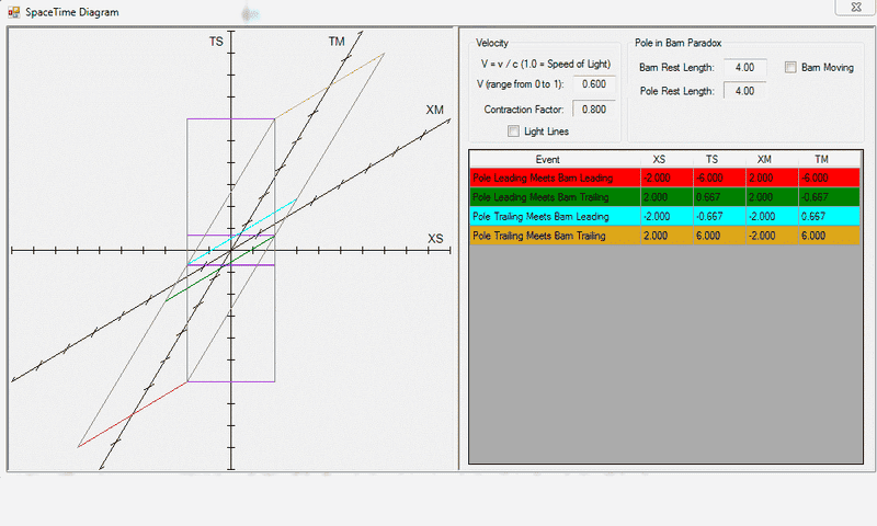

PeterDonis said:
Here's how you stated the condition originally:
In the battery's rest frame, coordinate time is equal to proper time for both terminals (because their clocks are synchronized in that frame). Terminal t1 is negative, and terminal t2 is positive (at least, I'm assuming that was your intended labeling--but actually the condition as you state it is symmetric between t1 and t2 so it doesn't really matter anyway). So #1 says that event N (negative terminal making contact with plate) has to happen before time tc, and #2 says that event P (positive terminal losing contact with plate) has to happen after time tc. Thus, event N must occur before event P in the battery's rest frame.
Here are two sets of numbers; the first gives results consistent with the scenario as stated in the OP--neither of our closed circuit conditions are satisfied--while the second satisfies your condition but not mine. All numbers are given in the battery rest frame.
Common Definitions
The spatial origin of the frame is equidistant between the positive and negative terminals of the battery. The time origin is at the instant when the spatial origin passes the geometric center of the copper plate (i.e., battery and plate are mutually "centered" on each other). The battery has rest length 2, so the negative terminal is at x = -1, and the positive terminal is at x = 1. The plate is moving in the negative x direction in the battery rest frame;. We use units where c = 1.
Scenario A
In this scenario, the plate has rest length 2, the same as the battery, and the relative velocity of the plate and the battery is 0.866, so the length contraction factor is 2, and the plate appears to be of length 1 in the battery rest frame. This leads to the following coordinates for events N and P:
Event N: (t, x) = (0.5, -1)
Event P: (t, x) = (-0.5, 1)
Note that event N happens after event P in this frame, and the events are spacelike separated, so neither of our "closed circuit" conditions is met.
Scenario B
In this scenario, the plate has rest length 4, and the relative velocity of the plate and the battery is 0.6, so the length contraction factor is 1.25, and the plate appears to be of length 3.2 in the battery rest frame. The event coordinates now are:
Event N: (t, x) = (-0.6, -1)
Event P: (t, x) = (0.6, 1)
Note that event N happens *before* event P in this frame, so your "closed circuit" condition is met. But the events are still spacelike separated: a light signal emitted from event N will reach the positive terminal at x = 1 *after* event P. So my closed circuit condition is *not* met; and the circuit will not actually close, because by the time the current within the battery that is initiated at event N reaches the positive terminal, that terminal is no longer in contact with the plate, so the circuit can't be completed.
Oh, now I think I get what you mean.
But, the conditions I set are sufficient to resolve the paradox. They focus on relativity of simultaneity. Your additional level of preciseness (and that of the author of the OP reference) turns the thread into a discussion of circuit theory. Is it really worth it?
If you're referring to the link you gave showing some times on the clocks - I have to say I'm not convinced by that argument. There's no doubt that in the track frame both electrodes are in contact for a time, and in the battery frame they are not. There's no simultaneity problem with that. The resolution comes about by considering the flows of charge, and the fact that the time for the circuit to close is greater in the track frame than the battery frame.

I spent some time studying the spacetime diagram for this plate and battery setup. To help me see it better, I doubled the rest lengths, shifted the start position and time to put the "middle" of the process at the origin, and added some time projection lines. The improved diagram is below. (I also found that saving the screenshot as a png avoids the smearing effect that I had with jpg.)
I'll make two observations now.
1. By what I consider the most natural reading of the referenced paper, the authors are saying that, in a given frame, an electrical signal will come into existence only when both terminals are in contact with the plate. In this scenario, that happens only in the rest frame of the plate. Therefore, an electrical signal exists in one frame but not the other. That cannot happen. In the OP, I called this a paradox. Now, I'll just call it incorrect. Perhaps the authors meant something else; then my complaint does not apply. As to whether they were thinking of retarded potential, perhaps they were. I don't think that changes the outcome of an em wave in one frame but not the other, based on what they actually said in the paper.
2. I was clearly wrong when I said that a terminal could be in contact with the plate in one frame but not the other. I saw that two days ago as I prepared my response to PeterDonis. What I was not able to do at that time was visualize the "combined" process, as opposed to two separate and independent processes. That's not a very good way to say what I have in mind, but that will have to do for now.
Looking at a specific event on the spacetime diagram, I can give you an idea of what I meant about one reality for the two frames, down to the particle level. (I don't refer to QED; I have a big enough headache already--and no desire to put my foot deeper into my mouth.)
At the origin of the spacetime diagram:
a) In the rest frame of the plate, both terminals have been in contact with the plate for some time.
b) In the rest frame of the battery, neither terminal has been in contact with the plate for some time.
Given the complexity of the problem, I am not going to say that current is flowing in the rest frame of the plate, but no current is flowing in the rest frame of the battery. Indeed, I am not going to make any prediction at all about the state of the plate.
What I will do is point out that in both frames the positive terminal (only) was in contact with the plate for some time, and thus some amount of charge passed into the plate. In the rest frame of the plate, when the second terminal comes into contact, the plate is already "primed" with charge, and thus the flow of charge would tend to increase. On the other hand, in the rest frame of the battery, when the terminal loses contact with the plate the flow of charge would tend to decrease.
I understand enough about inductance to know that sudden changes in current are resisted; not to mention the other complexities that have been talked about. So I am not making any disparaging remarks about relativity. What I am pointing out is that it is not at all obvious to someone who is not on the "inside" that everything will work out in practice so that when the state of the field in the plate is calculated from the perspective of the rest frame of the plate, it will match (after transformation) the state calculated from the perspective of the rest frame of the battery.
On the other hand, there is not much in this hypothetical case that is practical. So there is no point in getting too worked up about it. The only comment I can make of practical value is to suggest that physics textbooks for beginners would do better not to gloss over obvious difficulties. At the least, simplifications should be stated as assumptions.
