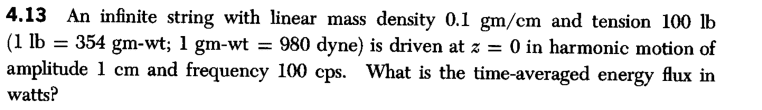

Printed textbook problem 4.13: An infinite string with linear mass density 0.1 gm/cm and tension 100 lb (1 lb = 354 gm-wt; 1 gm-wt = 980 dyne) is driven at z = 0 in harmonic motion of amplitude 1 cm and frequency 100 cps. What is the time-averaged energy flux in watts?
The answer is about 40 Watts, but i am really not getting it:
<Pot> = 0.5((pλ)(ωA)²)v
p density linar
λ wavelength
ω angular frequency
A amplitude
v phase speed
Why is this wrong?
(I already tried too by <Pot> = Z*(ωA)²/2)
Z is impedance

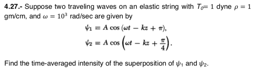

  • Textbook problem 4.27 giving two traveling waves on a string, psi1 = A cos(wt - kz + pi) and psi2 = A cos(wt - kz + pi/4), with T0 = 1 dyne, rho = 1 gm/cm, and w = 10^3 rad/sec, asking for the time-averaged intensity of their superposition.
Where is your working? How did you find the wavelength?
We cannot say what is wrong without seeing what you did.
v = √T/ρ = λ*f is what i am using to find the speed
