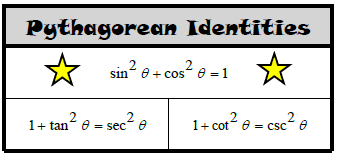

Finding the real component was straight-forward.
Q: how to determine sin ɸ without needing to determine ɸ itself?
I am guessing, I have to use the Power Triangle, with Apparent Power, on the HYP, Active power as the base of the triangle and Reactive Power as the vertical of the triangle. The triangle is a right-angled triangle. Am I right? :)

Oops, :oops: what I had in mind is a Pythagorean identity
Using that first one, you can find the magnitude of sine (x) if you already know cosine (x).
(I'm not sure why I decided to credit it to Euler, but Euler has enough to his credit without me heaping more still, even in error.)
