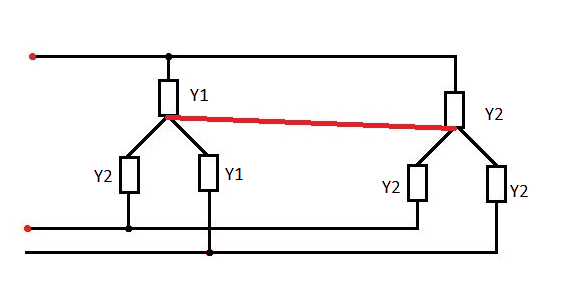

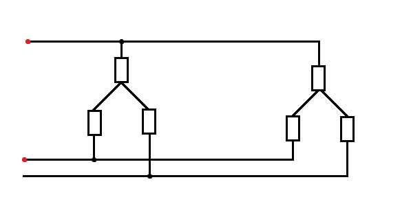

For part C would the circuit look like this (see picture) before I make it into 1 single Y load.
Part C also specifies: "...and with the star-points of the two Y-sub-circuits connected together," What do you suppose is meant by that?

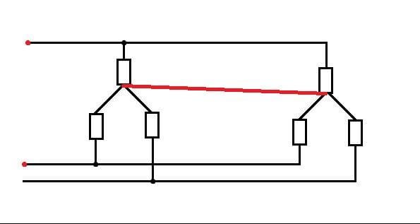

Would it be like this?
That would be my interpretation, yes.
ok brilliant i will give it a go. Thank you for your help gneill
So i have worked out that each of the impedance's would be 7.5+j7.5
Is this correct?
Is this correct?
Yes. But you could have verified this by checking the earlier parts of this thread.
