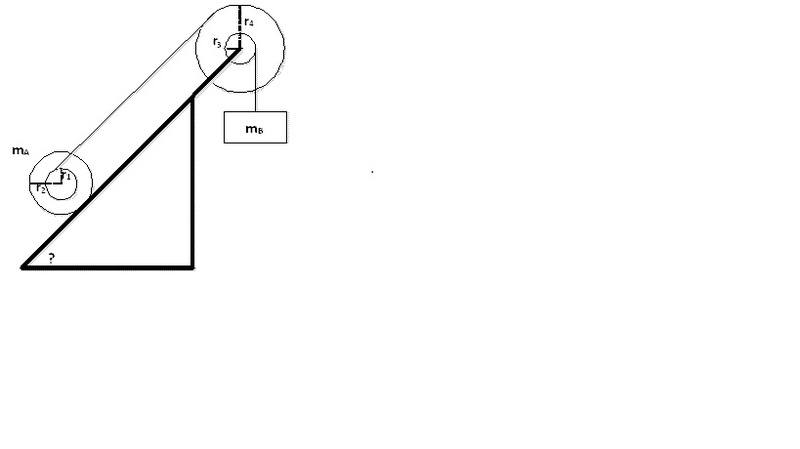

Find the acceleration of each object. Note: the question mark in the diagram should be θ (angle of inclined plane)
2. Homework Equations
τ = F . r
Στ = I . α
α = a / R
ΣF = m . a
For object A:
ΣF = m . a
TA - WA sin θ = mA . aA
TA - mA . g. sin θ = mA . αA . r1
Στ = IA . αA
TA . r1 = IA . αAFor object B:
ΣF = m . a
WB - TB = mB . aB
mB . g - TB = mB . αpulley . r3For pulley:
Στ = Ipulley . αpulley
TB . r3 - TA . r4 = Ipulley . αpulleyMy questions:
1. Are my equations above correct?
2. Is it correct that αA ≠ αpulley?
3. Can I state that aA = αA . r1 = αpulley . r4?
Thanks
songoku said:
My questions:
If object A rolls without slipping, there is a force on A that helps prevent slipping which you left out.
Yes! That's correct.
No.
For the first equality, you have aA = αA r1. Is r1 the radius that you should use here? Consider the condition for rolling without slipping of a wheel.
For the second equality, you have aA = αpulley r4. The relation between aA and αpulley is a little more complicated than this. (I assume that aA represents the acceleration of the center of object A.) It might help to consider the two colored spots painted on the sloping string shown below
Are the linear accelerations of the red and blue spots the same?
You mean friction between A and the plane? Can the torque for rolling being produced by tension A only?
No. No.
So, αA will be the same as αpulley?
I am not sure I get the hint. Is it correct if I use r2 instead of r1 because r2 is the radius of rolling?
View attachment 109619Are the linear accelerations of the red and blue spots the same?
I don't think the linear accelerations of the red and blue spots are the same. The linear acceleration of blue spot should be higher than red spot because blue spot will cover more distance in one rotation. The ratio of their linear accelerations will be the same as the ratio of their radius? (ared / ablue = r1 / r4?Can I also state that aA / aB = r1 / r3?
Thanks
Yes.
For general values of the masses, etc., it seems unlikely that the friction force would be zero.
No, they won't be the same. Sorry, when I read this part of your post I saw the symbol =, whereas you actually had ≠. I edited my earlier post.
Yes, that's right.
Note that there is a fixed length of string between the two dots. We assume the string cannot stretch.
No.
TSny said:
Yes.
If friction is considered, the equation will be:
ΣF = m . a
TA - mA . g. sin θ - friction = mA . aA
TA - mA . g. sin θ - friction = mA . αA . r2
Στ = IA . αA
TA . r1 + f . r2 = IA . αA
No.
Are their linear accelerations the same? They both have different angular accelerations and radius so it is possible for them to have same linear acceleration?
Thanks
ΣF = m . a
Στ = IA . αA
Yes.
Yes. Yes.
TSny said:
Yes.
Yes. Yes.
Object with radius r3 and r4 will have same α, so:
ablue / aB = r4 / r3 ; ablue = ared = αA . r2
aB = αA . r2 . r3 / r4
OK
ared ≠ αA . r2
αA . r2 gives the acceleration of the red dot relative to the center of object A. But ared denotes the acceleration of the red dot relative to the earth.
TSny said:
OK
ared ≠ αA . r2
So aA = αA . r2 that is used in the equation of Newton's law (ΣF = m.a) is the acceleration with respect to the center of object A, not with respect to earth?
aB = αpulley . r3
ablue . r3 / r4 = αpulley . r3
ablue = αpulley . r4
ared = αpulley . r4
ared / aA = r1 / r2 ?
Thanks
aA is the acceleration of the center of object A relative to the earth. For rolling without slipping, aA = αA . r2 .
aB = αpulley . r3
ared = αpulley . r4
All of this looks good.
This is not correct.
One way to get the relation between ared and aA is to use the idea of relative motion. You can think of the (tangential) acceleration of the red point with respect to the Earth as the (tangential) acceleration of the red point relative to the center of object A plus the acceleration of the center of object A with respect to the earth:
ared = ared/A + aA.
ared = ared/A + aA.
ared/A = αA . r1
ared = ared/A + aA
ared = αA . r1 + aA
ared = (aA / r2) . r1 + aA
aA = ared . r2 / (r1 + r2) ; ared = ablue = aB . r4 / r3
aA = aB . r2 . r4 / ((r1 + r2) . r3)
Is this correct?
Thanks
Is this correct?
Yes. Good.

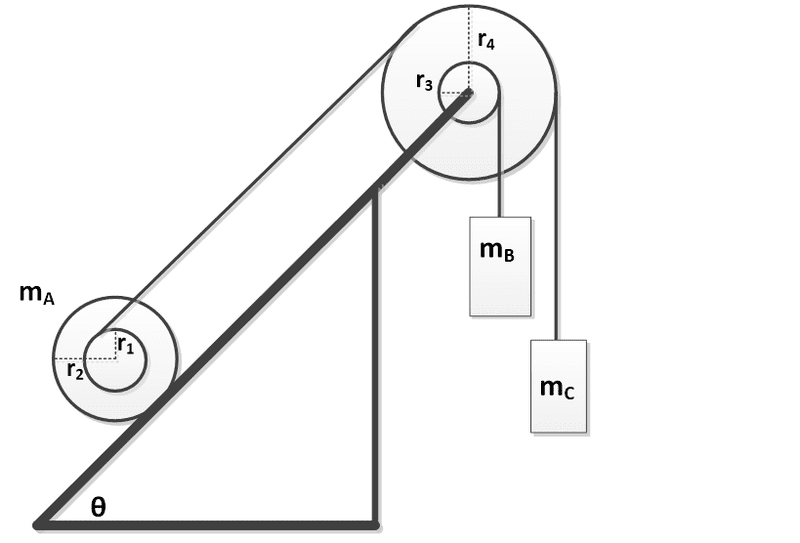

TSny said:
Yes. Good.
and the relation between αA and αpulley:
αpulley = αA . (r1 + r2) / r4 ?
I have another question similar to this one. I will do it first and then post it again. Thanks
Let the red spot and blue spot the same as question before:
ared = ablue = aC
ared = aA . (r1 + r2) / r2
aC = aA . (r1 + r2) / r2
aB / r3 = aC / r4
aB = aA . (r1 + r2) . r3 / (r2 . r4)
Is this good?
Thanks
Looks right.
ared = ablue = aC
aB / r3 = aC / r4
I think that's all correct.
Let red spot is the center of object and blue spot is the point where the tension touches object B
ared = ablue = aA
aA = αA . rA
ablue = 2 aB , so aA = 2 aB
Then:
aA = 2 aB
αA . rA = 2 . αB . rB
and: αpulley = αA . rA / rPIs this correct? Sorry for the trouble. My teacher didn't teach about this type of question but this is given as practice for the test today. Thanks
ared = ablue = aA
aA = αA . rA
Then:
aA = 2 aB
It all looks correct to me. Good luck on your test!
The question that came out was the third picture I posted and unfortunately the teacher aA = aB without any further explanation why...Thank you very much for your help TSny
Because of string constraint , the acceleration of center of A is equal to the acceleration of the topmost point of B .
As conscience stated, and as you showed in post #17, the acceleration of the center of A equals the acceleration of the point where the string meets the top of B. If the teacher stated that aA = aB, could it be that "B" refers to the top of mB? Anyway, I still think your analysis in post 17 is correct.
