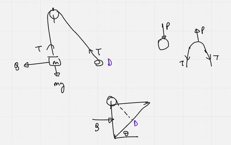

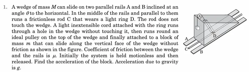

Consider the wedge as '1' and block as '2' : i need to find ##a_{2/F}=a_{2/1}+a_{1/F}## .
The FBD of '1' : $$Mg\sin\theta - f=Ma_{1/F}$$ $$Mg\cos\theta=N$$
The FBD of '2' : $$mg - T =ma_{2/1}$$
Assuming kinetic friction : ##f=\mu Mg\cos\theta##. But how do i find ##T##?
You are overlooking some forces. The string exerts a force on the pulley, while the wedge and block exert contact forces on each other.
You also have the constraint that the block does not penetrate the wedge.
But, unless I am missing something, the question is much simpler than it looks. Think about how the block moves relative to the wedge.
Is this correct? Seems fairly complicated . How do i handle all these tension forces , moreover since it's an ideal pully , the net force acting on it would be zero .
The net force on the pulley is zero, but the string exerts a force on it, so that force is transferred to the wedge.
As I wrote, think first about the relative motions of the two bodies.
