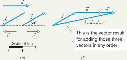

I have been trying to make sense of it using the pythagorean theorem and Law of Cosines but I just cannot break it. I have copied and pasted the problem below and included the graphic from the book.
Please help.
In an orienteering class, you have the goal of moving as far (straight-line distance) from base camp as possible by making three straight-line moves. You may use the following displacements in any order: (a) , 2.0 km due east (directly toward the east); (b), 2.0 km 30° north of east (at an angle of 30° toward the north from due east); (c), 1.0 km due west. Alternatively, you may substitute either -b for b or -c for c. What is the greatest distance you can be from base camp at the end of the third displacement?

Using a convenient scale, we draw vectors a, b, c, -b, and -c as in Fig. 3-7a. We then mentally slide the vectors over the page, connecting three of them at a time in head-to-tail arrangements to find their vector sum d. The tail of the first vector represents base camp. The head of the third vector represents the point at which you stop. The vector sum d extends from the tail of the first vector to the head of the third vector. Its magnitude d is your distance from base camp.

It's pretty easy to see what combinations of signs produce the max distance, and you appear to have solved that. So I assume the remaining problem is to work out what that distance is.
Can you work out what the northerly and easterly displacements are from vector b?

If you travel at 30 degrees north of east for 2km, how far north have you gone? It's simple trigonometry.

Your book should have some examples where they decompose a vector into components, with one component parallel to the x-axis, and another component parallel to the y-axis. If the vector makes an angle of 30° to the pos. x-axis and has a length of |r|, the x component is |r|cos 30°, and the y component is |r| sin 30°. This is right triangle trigonometry. Using the Law of Cosines isn't very helpful here, and the Pythagorean theorem (a special case of the Law of Cosines) isn't any use either.

That'll work here, by recognising that a 30 degree right angled triangle is half an equilateral triangle. That's enough to figure out how far north b goes, then you can use Pythagoras for the easting.

but what happens to c. It goes west 1km, so i switch it to go east 1km which makes it -c.
When i connect -c to the head of a (2km east) does that length now become 1, because 2 + -1 = 1?

c is 1 km west, so -c is 1 km east.
Therefore, a + -c is (2 km east) + (1 km east) =  ? 
