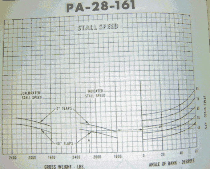

Here's a graph for a Piper Warior II that shows how to find stall speed for varying conditions. (sorry about the quality, it is a digital photo of a page from a book, compressed to fit the allowed attachment size.)
The Warrior has a "dirty" stall speed of 44 kts
Note that the actual stall speed can vary from about 35 kts (empty plane, minimum fuel, straight flight, full flaps.) to about 70 kts (maximum take off weight, 60 degree bank turn, no flaps).
Landing approach speed is 63 kts.

Note that stall speed is a way of relating speed and angle of attack for the benefit of the pilot. The stall speed is the speed at which the plane stalls in level flight (or in a level turn) based on the angle of attack increasing in an attempt to stay level (which is why it depends on weight). It's still the angle of attack that causes the stall.
