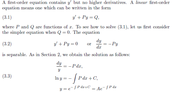

I would like to ask you why the author does not use absolute value of y instead of y?

##y=\pm \exp(-\int P dx +C)=\pm A \exp(-\int P dx)=A' \exp(-\int P dx)## and the sign can be put into the value of ##A##.

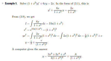

But in this example in the same source In calculating I, the integrating factor, the minus sign cannot be put into any value. Would you like to examine this?

So shouldn't it be as "3ln|1+ x^2|"

fresh_42 said:
When is ##1+x^2 < 0\,##?
Sorry for the mistake, this expression can be 0 for maximum value.
