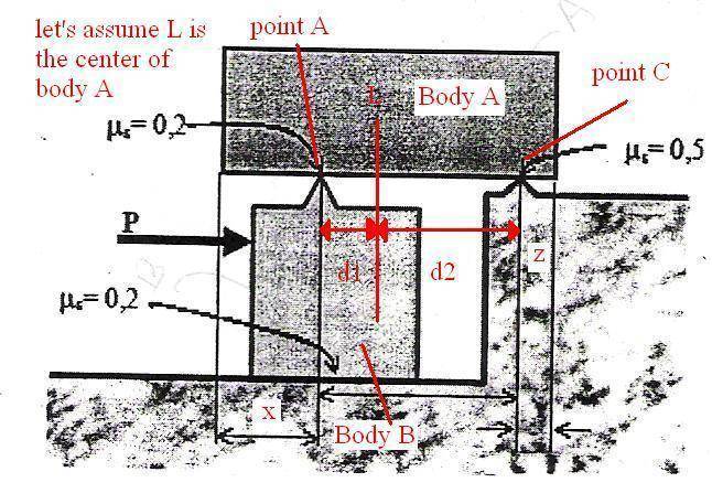

2) the body A 'weighs' 2500 kg. and body B 'weighs' 500 kg. \mu_{S} between A and B and between B and the ground is 0,2; and between A and the high surface is 0,5. Find the minimum required force P to start the movement of body B to right. Consider all the posibilities.
Ok, so when they say 'consider all the posibilities' i assumed that they meant that either x = z or x \neq z.
from there
forces acting on body A
\sum{F_X} = F_{A} = F_{C}
\sum{F_Y} = W_{A} = N_{A} + N_{C}
forces acting on body B
\sum{F_X} = P = F{_B} - F_{A}
\sum{F_Y} = N_{B} = N_{A} + W_{B}
\sum{M_{center \ of \ body \ A}}=\left\{\begin{array}{cc}N_{A} = N_{C},&amp;\mbox{ if }<br /> x = z\\\frac{N_{A}}{N_{C}} = \frac{d_{2}}{d_{1}}, &amp; \mbox{ if } x\neq z\end{array}\right.
\sum{M_{point \ A}}=\left\{\begin{array}{cc}\frac{W}{2} = N_{C} \ \mbox{(which, from previous balance of momentum)} = N_{A},&amp;\mbox{ if }<br /> x = z\\N_{C} = \frac{d_{1}W_{B}}{d_{1}+d_{2}}, N_{A} = \frac{d_{2}W_{B}}{d_{1} + d_{2}}&amp; \mbox{ if } x\neq z\end{array}\right.
so in both cases, i end up with P = 981 N, but as you can see \sum{F_X} of body A can not be satisfied if we were to satisfy also the \sum{M}, when x = z
from there
3) I'm really growing fond of this Latex typesetting. I've seen quite a lot software for writing documents with Latex. which one do you recommend the most, for writing papers and/or a thesis?
thanks in advance for any help you can give me
I think "all the possibilities" should put your focus on the relationship between d_1 and d_2. Your equation
\frac{N_A}{N_C} = \frac{d_2}{d_1}
or
N_C = \frac{d_1}{d_2}N_A
is valid as long as point A is to the left of center of Body A, which will always be true if it starts the left and the motion is gradual. Also
\sum{F_Y} = W_A = N_A + N_C
\sum{F_Y} = N_B = N_A + W_B
are valid all the time.
Two possibilities are that sliding occurs at point A before C, in which case
P = P_1 = 0.2 N_A + 0.2 N_B
OR sliding occurs at point C, in which case
P = P_2 = 0.5 N_C + 0.2 N_B
By the first ratio this is
P = P_2 = \frac{0.5d_1}{d_2}N_A + 0.2 N_B
If the first term in P_2 is smaller than the first term in P_1, then the slipping will occur at C.
Suppose the initial configuration favors slipping at A, which would be the case if d_1 &gt; 2d_2/5. The slipping results in a decrease in d_1 with no change in d_2 until the first term in P_2 becomes equal to the first term in P_1. On the other hand, if the initial configuaration favors slipping at C because d_1 &lt; 2d_2/5, d_2 will decrease with no change in d_1 until the first term in P_2 becomes equal to the first term in P_1. So what is going to happen when the distance ratio makes P_1 = P_2?

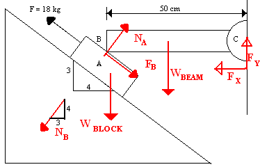

Weights: block A = 196.2 N (20 kg)
Beam BC = 245.25 N (25 kg).
The ramp in which block A lies is flat (i assume that means \mu_{between \ A \ and \ ramp} = 0)
\mu_{between \ Beam \ BC \ and \ block \ A} = 0.6)
the 'union' in C is simple and without friction. Calculate the force exerted over the beam in B.
ok, so i say 'oh, pretty easy, let's do the balance'
\sum{F_x} = -176.58(\frac{4}{5}) + N_{A}\frac{3}{5} + F_{BC}\frac{4}{5} - N_{BC}\frac{3}{5} = 0
\sum{F_y} = 176.58(\frac{3}{5}) + N_{A}\frac{4}{5} - F_{BC}\frac{3}{5} - N_{BC}\frac{4}{5} - W_{block \ A}= 0
and i get
N_{B} = 98.1 N
N_{A} = 255.06 N
and this satisfies the system above, but i was curios about 'then why was the beam weight given?' and i did a momentum sumatory in the beam, and the equation i got was:
\sum{M_C} = \frac{W}{2} = 0.6*N_{B}*\frac{3}{5} + N_{B}*\frac{4}{5}
and i get that N_{B} = 105.71
why?
i supposed that in C the union would exert a reaction, but still i got the same result because
\sum{M_B} = F_{Y \ in \ C} = \frac{W}{2}
and then F_{Y} - W + F_{B}\frac{3}{5} + N_{B}\frac{4}{5} = 0
so i got the same result again
that little difference... why does it ocurrs?
thanks again for your help, really, i appreciate it a lot
afromanam said:
uhmm from what i understood, if P1 = P2 then sliding would ocurr in both surfaces when d1 = 0.4*d2.
Let's think about this a bit more. It's fairly easy to see that if point A is sliding and point C is not sliding that Body A has no motion. To keep body A from moving to the right the force at C has to be equal to the friction force acting at point A, and has to be less than the maximum possible force at C. When d1 becomes equal to .04*d2, the maximum force at C is reached and Body A begins to slide at C. If the coefficients were constant and independent of motion, then these forces should be able to achieve a condition where they are both equal to their maximum possible values, both points would slide, and Body A would move steadily to the right at the speed necessary to maintain the d1/d2 ratio. This is consistent with your understanding of what would happen.
I don't think you need to incorporate this into your solution to the problem, but in reality the coefficient of kinetic friction is less than the coefficient of static friction, so what I think what would really happen is that if you start pushing Body B slowly to the right you would reach a point where sliding at C begins, which would suddenly reduce the frictional force at point C, making the frictional force at point A less than maximum and point A would stop sliding. When Body A has moved far enough to the right to increase the normal force at C (reducing the normal at A) point C would stop sliding and A would start sliding again. I think the motion would actually be a series of steps with alternate sliding at points A and C.
I think I see the problem you are having with the new one. It appears that you solved the first two equations assuming the block is moving so that
F_{BC} = 0.6*N_{BC}
and used that relationship to reduce the first two equations to 2 unknowns, then solved for them. Now you find the result is inconsistent with the equation for the beam. This is similar to what I did on that other problem, except that in that case there was motion and I had just made an algebra mistake. In this case, the applied force really is insufficient to make the block move. Assume you do not know the ratio of the frictional to normal force at B, and solve all three equations simultaneously. You will find larger values for the normal forces, and the ratio of the forces at B will be less than 0.6. Your last equation needs to be rewritten as
\sum{M_C} = \frac{W}{2} = F_{BC}\frac{3}{5} + N_{BC}\frac{4}{5}
I'm not sure what you were asked to find, but your result will show that the net force on the beam at B is not vertical and leans to the right. That means the reaction at C has to lean to the left. Your last equation is justified if you can assume the horizontal component at C is applied to the lower right corner of the beam. If it were applied at the center or the top, you would have to include the moment due to the horizontal components of the forces at B. Since the thickness of the beam is not specified, and the details of the support at C are not apparent, then I think your equation is OK. If there are details you have not included, then you need to consider the beam more carefully.
oops, data missing
yes, i was asked to find the force exerted by the block on the beam at point B.
