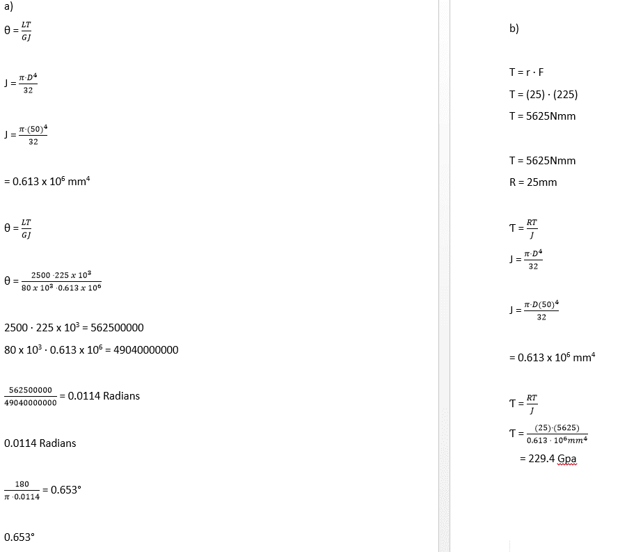

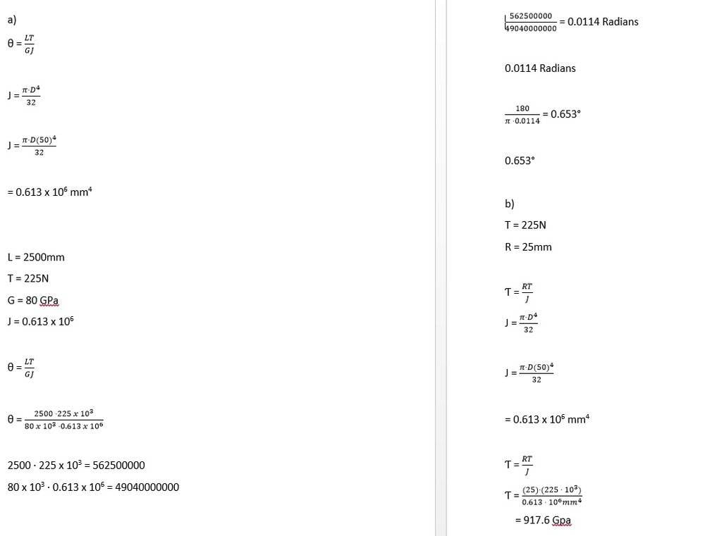

Hello,
I have attempted the question below.
I think i have correctly completed the question.
Could anyone see if i have gone wrong?
As trying to learn this.
I am just worried about the units m to mm. Also the answer being correct, 917.6Gpa. I was unsure what units to use on the answer.

It is not shown in the diagram, but the 225 N is a force, not a torque, and it acts tangent to the circumference of the shaft at its free end. What is the Torque caused by it? Then watch your conversion factors, there's a lot of zeros when using SI units.
So this whole calculation is wrong? Do i convert force to Torque? Thanks for replying to help
If you determine the correct torque and use it in your equations and check your math, and units, you will have it right!

Ok.
So i have:
T = r x F
T = 25mm x 2.5N
T = 5,625Nmm
Is this correct calculations for torque?
So i can then place in my calculations and try complete the calculation.
Thank you.
Yes, That's T= (25)(225) = 5,625 N.mm

Thank you.

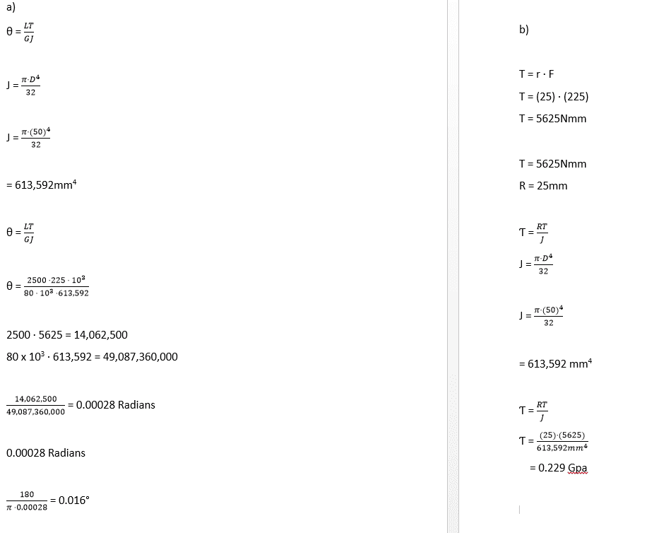

I have re calculated.
Is my answer now correct?
Conversion factors is where i struggle.
That’s for sure. Your answer for torsional shear stress is off by a factor of one million. Don’t feel bad, I’m from the US and I seldom use metric , so it confuses the living daylights out of me. Once I ordered 1/4 inch thick plate from China and they offered me 6mm instead. It took me awhile to convince myself that it was more or less the same. Except a lot cheaper than steel from the US mills.
And you didn’t correct your angle of twist!
I hope you get it right next time, because it takes me forever to do the math because of all those zeroes and mega and giga stuff. 😷
I thought angle of twist was correct. Not sure where i have gone wrong there?
I was have another attempt and post.
I hope i get it right this time too!
Thank you for your help. Very much appreciated.
My attempt with new calculations.
I think this is now correct.
If not where am i going wrong?
The numerical values are correct this time, however, the maximum shear stress near the surface of the shaft should be 0.229 MPa (millions of Pascals) rather than GPa (billions of Pascals).

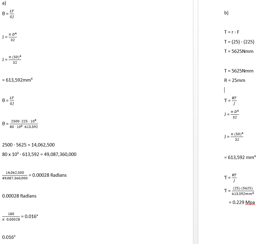

Thank you for this.
The links will help me.
I am going to attempt another question to try and get use to doing the calculations.
So i have changed to Mpa.
So this is now correct? So i can use to help solve another question.
Your help is very much appreciated.
Yes, I believe all is correct now.
