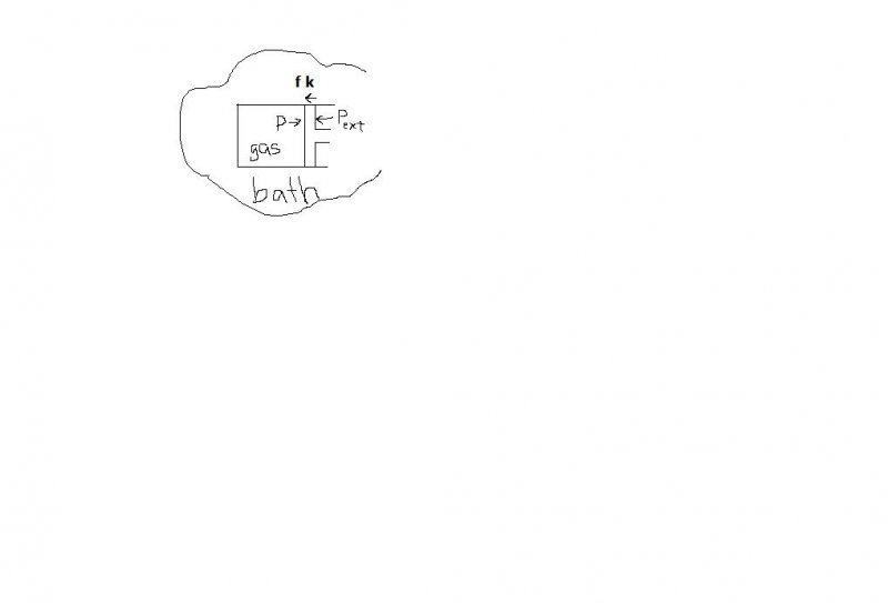

Thnx Chet. I attached a diagram with three forces/pressures acting on the piston: internal pressure of the gas P, external pressure Pext, and fk due to kinetic friction. I've assumed the gas is undergoing expansion. I'm not sure about the supplemental force that you've mentioned though. I'm also confused about your choice of system.
Yes. The diagram is correct. I see that you had the cylinder sitting in a bath. I was assuming you were going to be taking the system to be adiabatic when you wrote PVγ=const.
The "supplemental" force I was referring to is what you called Pext. So the force balance on the piston is, as you indicated,
##PA - F = P_{ext}A##
Is it gas + piston, with the cylinder as surroundings? or is it piston+ cylinder?
Sorry. I meant to say, treat the gas and piston as a combined system, and adiabatic cylinder as part of the surroundings.
##PA - F = P_{ext}A##Sorry. I meant to say, treat the gas and piston as a combined system, and adiabatic cylinder as part of the surroundings.To do this problem, you have to decide where the frictional heat is going. If it all somehow goes into the surroundings, then the gas experiences exactly the same treatment as in an adiabatic reversible expansion, and your PVγ is correct. On the other hand, if part or all of the heat goes into the gas, it experiences a different treatment, equivalent to a non-adiabatic reversible expansion. I was assuming that you wanted to consider the case in which all the frictional heat goes into the gas.
Chet

##-dq=-Fdx##
where dq is the heat flow into the piston from the unit at the piston interface with the "unit" (there is no heat flow at the cylinder surface of the unit).
Chet
This is also correct since you are taking dq as heat flowing OUT of the "unit".
Amin2014 said:
Yes thankyou. I never implied the cycle is carnot. If friction exists, the cycle is not carnot, period. Friction causes irreversibility, while the carnot is defined to be a reversible cycle between two (constant temperature) reservoirs.
In other words, reversibility is embedded in the definition of carnot cycle; there's' no such thing as an irreverible carnot.
You can have a Carnot cycle with friction. It is just that you can't have the friction causing heat flow into the system.
The reversibility of the Carnot cycle relates to the thermodynamic cycle. It does not depend on how the work output of the engine is used.
