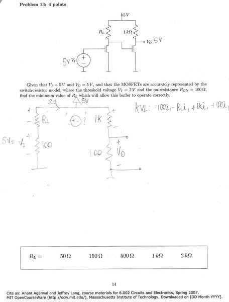

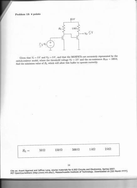

See figure
V = IR
I have a few questions about notation before I begin with an attempt at the problem.
Are there 2 voltage sources in this circuit diagram? One on the left, one ontop?
Also it says that Vo = 5v, does that mean they want to me to create this "buffer" so that the voltage measured at the port Vo is 5V?
Also what do they mean by a buffer?
I'm pretty confused as to how I should be manipulating the resistance RL, what kind of effect am I looking to create to make a "buffer"?
Thanks again guys!

Yes* (Though a down pointing arrow is sometimes ground, I'm assuming this symbol which I have never seen before is a 5V source, since I get an answer that is one of the five given if I do)
Yes
A buffer is some sort of separation device usually. It has the same value input and output and provides a barrier against an undesired situation occurring.
You know that the MOSFETS's are turned on by 2V, the MOSFET's can be replaced with a 100Ohm resister if they are turned on, and that the first MOSFET has 5V going into its gate.
This implies the first MOSFET can be replaced with a 100Ohm resistor. To get 5V at the output the second MOSFET needs to be turned on though. How will you do that?
* (Given my assumption that the up pointing arrow is a 5V source, leaving the second MOSFET off would result in no voltage drop across the 1kOhm resister and therefore 5V at the output ... can anyone comment on that?)

No, by buffer they are referring to the whole circuit. When the circuit is operating properly the output voltage will be 5 V.
Thanks again guys!
All they want you to do is find the minimum value of resistance such that the voltage at the gate of the last transistor will result in an output of 5 V at the drain. What are the conditions that need to be satisfied to get 5V on the output?
Does my circuit look like what I've drawn? (see figure)
If I want to get 5V on the output I need the second MOSFET turned off correct? Otherwise Vo would read 0V, no?
I need RL to have the voltage drop of atleast 3.1V so that then second MOSFET won't turn on, correct?

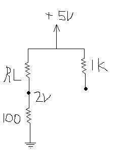

jegues, you seem to be right the MOSFET on the right must be off, therefore the voltage of the gate of the second MOSFET must be less than 2V. Now remember Von is Vgs, and the source is at 0V therefore the gate must be less than 2V.
Doing a simple voltage divider.
2=5*(100/(RL+100)), we find that RL=150 ohms.
I hope this helps.
This all makes perfect sense, the only trouble I'm having is seeing how the 100ohm resistor from the first MOSFET is in parallel with RL.
Does the circuit look like the figure I've drawn? Does current run through the red wire even though it's a short? Wouldn't all the current just run down the red wire and completely skip over the other black wire containing RL?

Ok jegues, let’s take it one step at a time. Remember that a MOSFET is basically a switch is going to be either ON or OFF. From previous analysis we have concluded that the MOSFET on the left will be ON while the one on the right will be OFF. Taking this into account, I have provided an equivalent circuit which is attached. The mistake you made is that you included the 5 volt source for the first MOSFET. This is not correct because this voltage simply determines whether the MOSFET is ON or OFF. Once the MOSFET is ON then the drain and source become “one wire”. Looking at the equivalent circuit we see that RL and the 100 ohm resistance are in series. We know we want less than 2V at the top of the 100 ohm resistor because this is where the gate of the MOSFET is being fed. Now we simply perform the voltage divider 2=5*(100/(RL+100)). Also, the right MOSFET can be modeled as an open, since we are designing it to be OFF.
The current would not run down the red wire you draw simply because this is NOT a short. As a matter of fact the key characteristics of MOSFET’s is that gate current is very near 0 amps.
