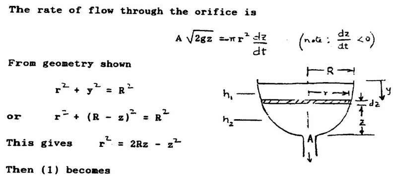

Applying Bernoulli's to this geometry.
11 replies · 2K views · last reply
pyroknife
611
I have attached the geometry of interest with some parts of the solution. The geometry is a vessel that is half of a sphere with an orifice at the bottom.
The first expression that they have written, the "A*(2*g*z)^0.5=..." is from conservation of flow rate. 2*g*z is the velocity at the inlet of the orifice.
I don't understand how they got that velocity since there should be a pressure drop from z to the orifice opening.
Basically it just seems like they did Potential energy (@ z) = Kinetic Energy at orifice opening.
So that gives g*z=0.5*v^2=>v=(2*g*z)^0.5
but isn't there a pressure gain as well of density*gravity*z?
The only way they could have gotten that velocity is if the pressure at both locations are the same.
  • Handwritten derivation of orifice outflow from a hemispherical tank: A sqrt(2gz) = -pi r^2 dz/dt, with r^2 + y^2 = R^2 and r^2 = 2Rz - z^2, beside a diagram of the tank with radius R, slice thickness dz and orifice A.
This problem is an application of Torricelli's Law, which is a particular form of the more general Bernoulli equation:
http://en.wikipedia.org/wiki/Torricelli's_law
The pressure at the open top of the sphere and at the bottom where the outlet is are approximately equal to each other and to the ambient atmospheric pressure.

Thanks for the reply. What you stated above I agree with, but isn't that different from what the drawing shows? it looks like at height z is at a location that is not exposed to the ambient pressure and same with at z=0 (orifice opening)? That's what has me confused.
If Z is indeed at the top, wouldn't Z=R?
Thus the expression should be 2*g*R, instead of 2*g*z.
It looks like z is some arbitary height, at z=R (P=Patm), but at other points below R, it should be Patm+(density*gravity*(R-z)) from the hydrostatic pressure relation.

I think z is the instantaneous level of the fluid.
Sorry, what does that mean?

The cross sectional area at the top of a huge tank like this is usually assumed to be much larger than the cross sectional area of the oriface, so the kinetic energy at the top is usually neglected in Bernoulli.

It means the fluid surface is at z.
Hmmmm I see, that would explain velocity=0 there and P=Patm. What about at z=0. Would you make an assumption that's the bottom surface (lack of a better term)?
Yes.
Look at the given equation r^2 + (R - z)^2 = R^2
so if z=0, r=0 as the figure corroborates.
It also states dz/dt < 0 which again implies z=0 at the bottom.
The figure should have indicated z as going + from the bottom to the surface instead of an ambiguous two-way arrow.
