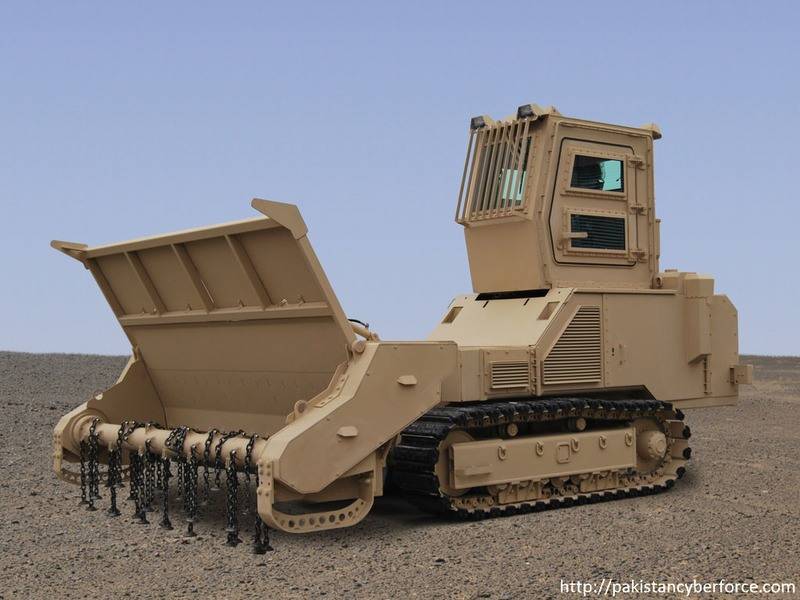

Hi, I am a Industrial Design student working on my senior Thesis. Since antipersonal landmine cleareance is a very dangerous process; I am working on a remote controlled vehicle concept that will be able to do a controlled detonation. That way the human won't have to manually disarm the landmine which is the current dangerous and slow process. Basically to detonate a landmine you need no more than 10 pounds of pressure. The only thing I can think of is compressed air, but obviously is a problem to have those compressed air tanks next to a explosion, even if is controlled.

Welcome to the PF.
What has been used in the past for doing this? How are you going to improve on existing technologies?
http://2.bp.blogspot.com/-poBh5X4vP...k/s1600/USZ+Mine+Sweeper+Tank+(Mine+Wolf).jpg
Likes NTL2009 and ferchotous
As pictured above, the reliable technology was developed 75 years ago. https://en.wikipedia.org/wiki/Mine_flail
On solid ground, the flail will give a very high clearance confidence at a very low cost of consumables.
The relative cost to the enemy of the original mines and the cost of mine clearance to the survivor is not important. The problem should be resolved safely for minimum cost. A pneumatic actuator would be quite expensive if it was destroyed each time a mine was found. If the location of the land mine is known then it can be counter-mined with a small explosive charge. That can be arranged to give the best probability of cutting the trigger mechanism from the mine, possibly without detonating the main charge. An alternative would be to use something like a shotgun to apply the pressure to the mine. A heavy shotgun barrel will survive the detonation of the mine.
In soft ground such as a swamp or rice paddy, the mines may circulate up and down until it may be triggered at the surface years later. Where stray land-mines may have surfaced, a dense herd of goats or sheep are driven through prior to planting. The cost and probability of killing an animal is small, but it can still feed the village. The small area of hoof that does so much damage to the land while grazing increases the ground pressure needed to trigger a mine.

I have looked into those big deminer trucks, the problem is the logistics to move them from one country to the other makes them very expensive, the other issue is that you have very uneven terrain with small paths where they don't fit and they will highly damage the ecosystem. They are mainly used to clear a specific path so the military demining, I am focusing on humanitarian demining.
