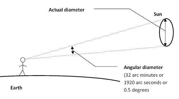

Diagram of a stick figure on Earth viewing the Sun, with dotted lines from the eye to the Sun's top and bottom edges. Labels: Actual diameter (across the Sun), Angular diameter (32 arc minutes, 1920 arc seconds, or 0.5 degrees, marked at the viewer's eye).
  • Diagram of a stick figure on Earth viewing the Sun, with dotted lines from the eye to the Sun's top and bottom edges. Labels: Actual diameter (across the Sun), Angular diameter (32 arc minutes, 1920 arc seconds, or 0.5 degrees, marked at the viewer's eye).

Nope. Seen from orbit the sun still has an angular size of ~0.5°.
