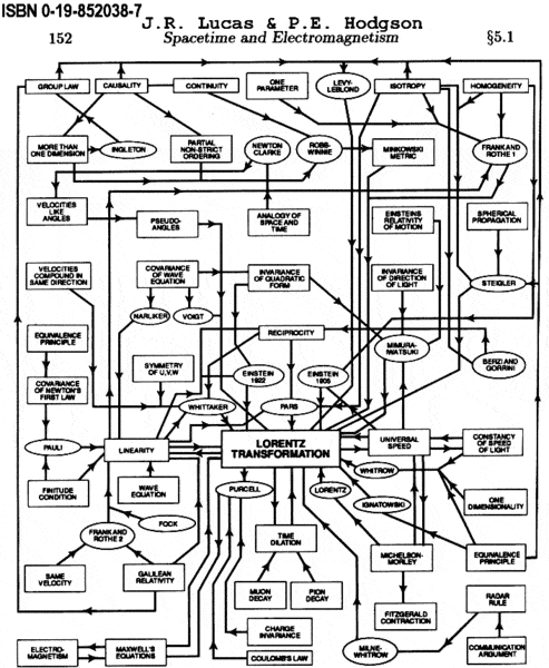

IMHO, there is some pedagogical value in short derivations... as long as it reflects and emphasizes the physics. Such attempts are not unlike the numerous attempts to derive the Pythagorean theorem.
FYI: Some philosophers of science are interested in various approaches to deriving the Lorentz Transformations from a minimal set of starting principles and assumptions. This attachment is appropriate for this topic: https://www.physicsforums.com/attachment.php?attachmentid=4406&d=1122686537
The [certainly longer than two-line] derivation by A.A. Robb using the causal structure is especially remarkable.
It seems to me that a true two-line derivation of the Lorentz Transformation should be modifiable into a two-line derivation of a Euclidean rotation... unless something very special for Minkowski spacetime is being used. So, what is this analogue?
Rather than "circular", it's probably more accurate to say there are probably additional assumptions that are not stated explicitly... suggesting that more "lines" are needed than the claimed "two". I haven't studied the proof presented in the first post... however, how obvious is the introduction of f(V)? Does its discussion imply more "lines"?
