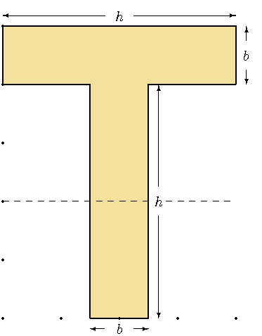

The area moment of inertia about the dashed axis is what?
Paralell Axis theorem
(1/12)bh³ + (1/12)hb³ + bh(h/2 + b/2)²
I don't understand how I am wrong
Looks right to me, though you could collect up some similar terms. What is the official answer?
