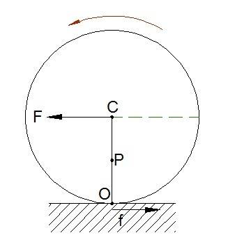

Around which points to make T=I(alpha)
  • Thread starter Thread starter Karol
    Points
The discussion centers on the application of the angular momentum formula T=Iα around different points for a cylinder rotating on a rough surface. Calculations show consistent angular acceleration (α) results when using points A and C, but a different result arises when using point B, indicating the importance of the chosen reference point. The conversation highlights the necessity of including friction in calculations and clarifies that the parallel axis theorem is applicable primarily at the center of rotation. Participants also delve into the derivation of angular momentum equations and the significance of the center of mass in these calculations. The thread concludes with a focus on the complexities of deriving angular acceleration and the nuances of applying these principles correctly.
Karol
1,380
I was told that I can use the rigid body angular momentum formula T=I\alpha
Aroud 3 points: a fixed one (I assume the temporary center of rotation), or the center of mass or a point moving parallel to the c.m.
I have tested it with the case shown in the picture: a cylinder rotating on a rough surface, a steady force acting on it's center.
When calculating the angular acceleration \alpha round the points A and C I get the same result, but when calculating around B-a different one, meaning the above is correct.
Why is that? the formula L=I\omega is derived this way:
L=\sum_{n=1}^N L_n=\sum_{n=1}^N m_nv_n\cdot r_n=\sum_{n=1}^N m_nr^2_n \omega=I\omega
So, I understand, in order to get the velocity of the particle correct, I have to calculate only round the stationary point of rotation. The formula T=I\alpha is only the derivative of the former.
Can anyone explain a bit, and give a name of a book that explains this in detail, since some ordinary books talk only in general about this.

There's friction and I included it in my calculation for point B. Around point A:
T_A=I_A\alpha[/itex]<br /> FR=(kmR^2+mR^2)\alpha\Rightarrow\alpha=\frac{F}{mR(k+1)}[/itex]&lt;br /&gt; &lt;br /&gt; I get the same \alpha when I calculate round point C.&lt;br /&gt; What is the friction force f ?&lt;br /&gt; \sum F=ma\Rightarrow F-f=ma=mR\alpha=mR\frac{F}{mR(k+1)}&lt;br /&gt; \Rightarrow f=F\frac{k}{k+1}&lt;br /&gt; &lt;br /&gt; Around point B:&lt;br /&gt; &lt;br /&gt; T_B=I_B\alpha[/itex]&amp;lt;br /&amp;gt; &amp;lt;br /&amp;gt; F\frac{R}{2}+f\frac{R}{2}=(kmR^2+m\frac{R^2}{4})\alpha&amp;lt;br /&amp;gt; \Rightarrow \alpha=\frac{2F(2k+1)}{mR(k+1)(4k+1)}&amp;lt;br /&amp;gt; &amp;lt;br /&amp;gt; And it&amp;amp;#039;s not the same as the first.&amp;lt;br /&amp;gt; How do you, Tiny-Tim, know this subject with no book to offer?
Hi Karol! :smile:
Your formula τB = IBα is wrong :redface:
The angular momentum about any point P is Iω about the centre of mass (C) plus the (ordinary) moment about B of the total momentum (mvc.o.m.) as if it were at C.
ie LP = ICω + m PC x vc.o.m.
If P is on the axis of rotation, then vc.o.m. = PC x ω, and so LP = (IC + md2)ω = IPω.
In any other case, LP is not IPω
(and τP is not IPα) :wink:

I try to calculate \alpha around point P, as drawn.
I don't get the right answer, since I get a different \alpha at points O and C, which is (round point O):
M_O=I_O\alpha\Rightarrow FR=(KmR^2+mR^2)\alpha<br /> \Rightarrow \alpha=\frac{F}{mR(K+1)}
I take the derivative of LP = ICω + m PC x vc.o.m. and get MP = ICα + m PC x ac.o.m..
I find the friction force, with the help of \alpha:
\Sigma F=ma \Rightarrow f=F\frac{K}{K+1}
\Rightarrow\left(F\frac{R}{2}\cdot f \frac{R}{2}\right)\hat{z}=mR^2\left(K+\frac{1}{4}\right)\vec{\alpha}+\left(m\frac{R}{2}\cdot\frac{F}{m(K+1)}\right)\hat{z}
\alpha=\frac{4FK}{mR(K+1)(4K+1)}
Which is not the same as the previous I found.

Hi Karol! :smile:
The dot should be a +, and the "+ 1/4" shouldn't be there.
Then your equation becomes
(2K+1)R/2(K+1) = (Rα/a)2KR/2(K+1) + R/2(K+1) :smile:
The "+ 1/4" should be there since point P is on the half of the radius.
And there is no F in your equation.
The (K + 1/4) is supposed to be part of IC not IP, so the "+ 1/4" shouldn't be there
(I canceled the Fs … ok?)
You cannot cancel the Fs, it doesn't appear in the α member:
\left(F\frac{R}{2}+f \frac{R}{2}\right)\hat{z}=KmR^2\vec{\alpha}+\left(\frac{R}{2}\cdot\frac{RF}{m(K+1)}\right)\hat{z}
oh, that (Rα/a) shouldn't be there …
that should have been …
(2K+1)R/2(K+1) = 2KR/2(K+1) + R/2(K+1)
(using α = F/MR(K+1))
First, you can't use α = F/MR(K+1) since I have to find α.
Second, your last m PC x ac.o.m. member, R/2(K+1), is not correct.
It should be:
\left( \frac{R}{2}\cdot\frac{RF}{m(K+1)}\right)
Which gives FR2/2M(K+1)
Yes, I can … you found α from calculations based on the centre of mass.
All I had to do was show that that was consistent.
Yes it is, it's exactly the same as yours, except for a factor of RF/M which I took out from the whole equation.
  • #31
I want to find (alpha), but I don't succeed:
\frac{FR(2K+1)}{2(K+1)}=KmR^2\cdot \alpha+\frac{FR^2}{2m(K+1)}
Which doesn't give the previous (alpha).
