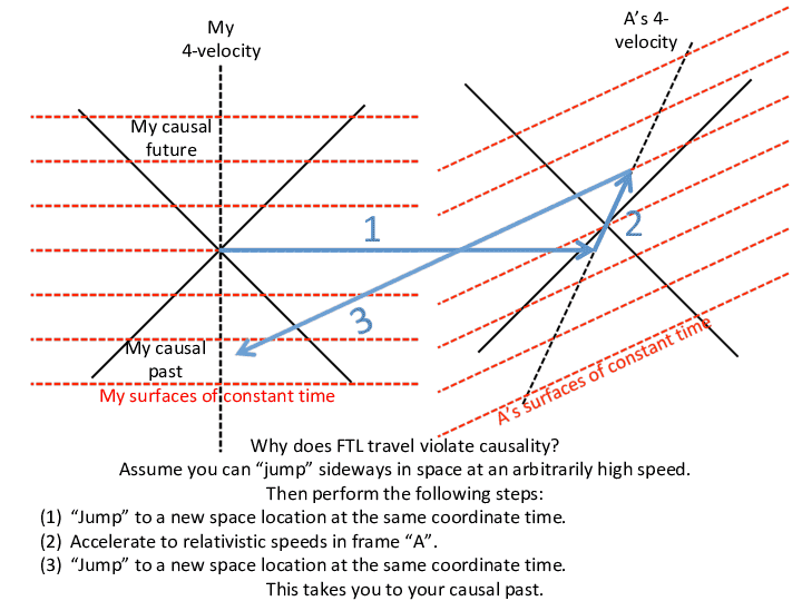

I generated this image to show how you could get to your causal past if you could travel faster than light. It may be a little bit misleading, because it assumes that the laws of relativity apply, except you can go faster than light, which is a logical contradiction. But I think it shows why people say, "If you could travel faster than light then you could affect events in your casual past."

Sorry, there's a slight error in your diagram. The line labelled "A's 4-velocity" should be tilted clockwise from vertical, not anti-clockwise.
Thanks phyzguy, that diagram helps. I have seen the triangle to the left of your number 2 before but it was on a single diagram. Drawing it in 2 separate diagram makes more sense now.

I don't understand your comment. Doesn't it just depend whether A is moving toward +X or -X?

If A's 4-velocity is as you drew it, then "A's surfaces of constant time" should be tilted the other way, i.e. clockwise from horizontal.

Your axes are rotated in a Euclidean sense, not "scissored" in the Minkowski sense. It captures the effect, but the details aren't right.

I see what you mean now. Let me try and fix it.

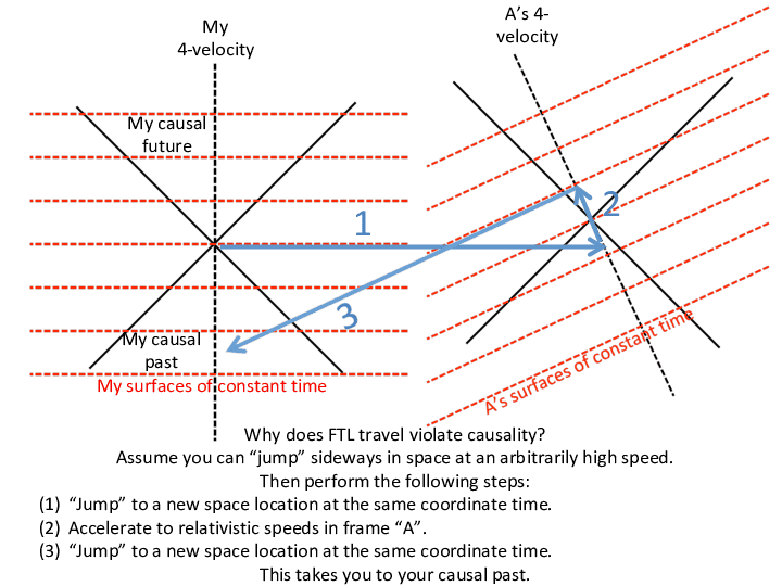

Thanks to @DrGreg and @Ibix for pointing out the error in my diagram. I think this is now correct (let me know if not!). The conclusion is the same as before.

Thanks all, the whole concept seems even more far-fetched than before now with Steps 1 & 3 featuring some kind of instanteneous "jump." Doesn't this instanteneous jump mess about with Relativity of Simularity? This seems to be getting too theoretical even for theoretical physics :)

Any motion faster than ##c## is instantaneous travel in some frame. In other frames, it can be even faster.

That's kind of the point, yes. But the anti-telephone effect works for any super-luminal motion. It's just easiest to illustrate in the "instantaneous travel in some frame" case.

Any faster than light travel does. Because of relativity of simultaneity , the beginning and end of a FTL journey will be simultaneous in some frame.
