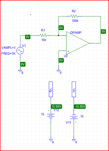

Hi, i am using Pspice schematics to build up an inverting opamp with 10 gain using an input sinusoidal source. For other opamp model, i will need to connect Vp and Vn to the top and bottom of opamp. But for this opamp (shown in the fig. below). Where should i connect my Vp and Vn? And how can i use the simulation to find the gain? i try to use create netlist-->simulate
and it said my some error on my circuit.
I have try to search the example in google but cannot find any basic opamp with sin source. Most of them are using 741 or other model so they got the top and bottom connection in opamp.
For other opamp, i have connected like this. The opamp pin 4 and 7 have been connceted to Vp and Vn. But i don't know how to connect those into my basic opamp?
Thank you

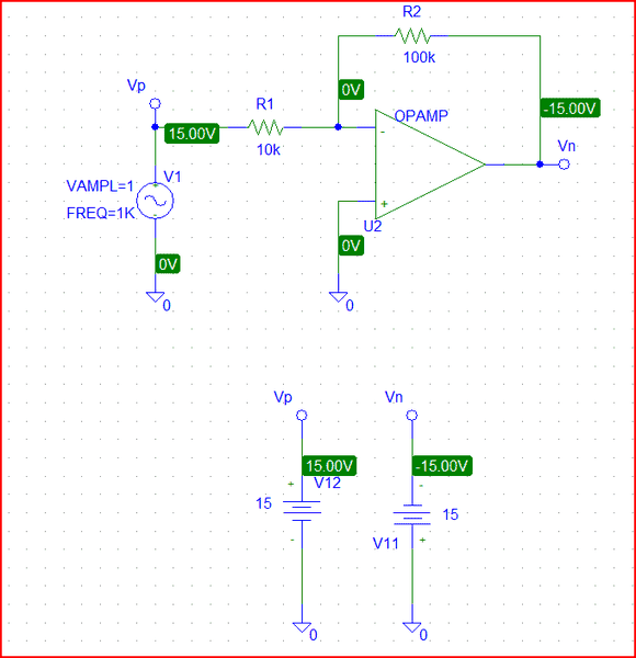

Hi, I am using PSpice Student V9.1 Schematics. I did not edit any setting in the opamp. I have try to connect it like that(fig. below) but it still not working. It said some problem with my voltage source
Remove the inverting input resistor from the positive supply. You just need the signal source here.
Also reduce the output of the signal source to 0.05 volts so the output should be 0.5 volts peak, but inverted.
It seems to be working as you would get an output equal to almost the voltage of the negative rail with your circuit, and that is what you are getting.
Are you observing the waveform at the output of the opamp?

How come there is a 15V label at Vp? If you have +/-15V supply and you have an offset at Vp and a gain of -10, you are not going to get any wave form at the output, all you get is -15V hung on the rail!
I think the problem is the Vp =15v at the input.

I have try to what u suggest. The circuit seems like not working. If i reduce the output source to 0.05v the output will be 0.05v(there is no gain?) I cannot do the simulation to get the waveform because it said there is an error in my circuit but it doesn't say what kind of error is that
Yes:(. i cannot get any gain. What i get from the waveform is just the my voltage source(-/+ 15V). Do you think i put my source at the right place?

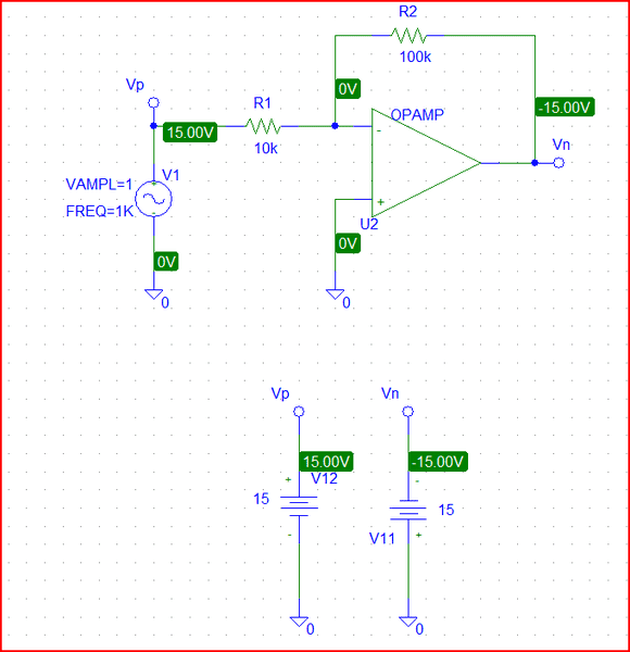

Is it possible for you to remove the Vp from the input signal (V1)
The other circuits you have drawn do not have Vp connected to the input
If you cannot remove 15V at Vp, then put the supply voltage at +/-180V! You should see the wave form riding on top of -150V offset.

You should be able to connect wires from the power supply to the opamp. This will get around any problems with labels.
The only input should be the 1 KHz signal generator. This should be checked to see if it has any DC offset. Look in the properties of the signal generator to see if there is any.
I specified a small signal of 0.05 volts AC to see if there was any DC offset in the signal generator.
With a gain of 10 the output should be a 0.5 volts (peak voltage) sinewave centered on 0 volts

That looks to be the key point. You are trying to use the symbol "Vp" as both a test point (on top of the signal generator) and as the label for a power supply.
The original circuit looks ok and it should have a voltage gain of -10. The feedback resistor is connected to the correct input if you wanted an Inverting amplifier.
As long as the supply voltage connections are correct, the circuit should work fine.
You should definitely not be connecting an input to Vp as that will force the output to limit at -Vn.
If you change R1 to 100k, the ac gain should be -1. The input (-) pin should always measure at very nearly 0V because that point is held at a 'virtual earth' potential because of the action of the negative feedback.

There certainly is a problem. In this arrangement https://www.physicsforums.com/showpost.php?p=3680661&postcount=9 it seems you have your -15v power rail connected to your op-amp's output pin. It does not belong there. You also have the signal source shorted out by the +15v rail. Remove this, too. The power supply doesn't connect to those pins of the IC. You have to find the V+ and V- pins for that IC and connect the power there!
I understand that you haven't found which pins those are, but that doesn't mean you can connect the power supply anywhere you like. You have to connect them correctly. As someone pointed out, maybe that model doesn't require explicit connection to the power supplies? But that's unlikely; I think you just have to look harder to find the correct pins.

There certainly is a problem. You have your -15v power rail connected to your op-amp's output pin. It does not belong there. You also have the signal source shorted out by the +15v rail. Remove this, too. The power supply doesn't connect to those pins of the IC. You have to find the V+ and V- pins for that IC and connect the power there!
Are you confusing connection to a source of PD and a measured value? I think the green rectangles contain measured values.
When you use the simple op amp model you don't need power supplies, they are properties of the model (by default I think +15V and -15V). Your first circuit was OK apart from the parts you added to try to implement power. Remove those completely and it should work.
