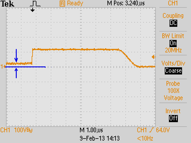

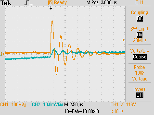

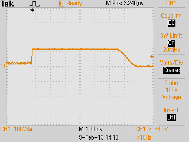

I just went to the trouble of plotting the data and is clearly is a plot of the volts when the switch is Closed and shows the exponential decay in current build up . The ratio of those volt readings, as a fraction of the next, is about 2.7, throughout the period - so it really does have the time intervals in units of time constant.
Problem is that that time constant has nothing to do with the time constant involved when the switch is opened. One thing I was right about was the advice to draw a graph before trying to come to conclusions. :redface: - but I did hope the OP would have done that.
Even more :redface:, I have just found that (power point) link and read it in full. Quantitative data is only shown for the switch on situation and they are totally non-committal about the timing involved between when the switch is opened and the neon strikes. They are not actually saying 'instantaneous' and nor are they saying what causes delay or how to work it out.A perfect switch has no capacitance and will instantly (on a timescale compared with other effects in a practical / inductive circuit) go to infinite resistance. Any inductor will have self capacitance and it is this that introduces a finite delay and subsequent 'ringing'. This can always be seen on relay windings, driven by a transistor switch, for instance. After the switch goes open circuit, NO current can flow 'around the circuit' but charge flows into the self capacitance of the coil (or anywhere else it can find; the switch capacitance is unlikely to be more than a very few pF, however). The time constant involved is much much shorter than the time constant for energising the coil, though. Any simpler treatment of the topic has to involve the words 'instantaneous' and 'infinite' - which are not very helpful. Neither is that PP presentation very helpful because it peters out without giving any quantitative help about what actually makes the neon strike.
Annoyingly, they quote a conventional car ignition system as an example of this effect. We all know that, without a suitable 'condenser' in place, it just won't work properly. Same goes for a Rumkorf Induction coil.

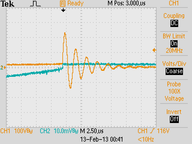

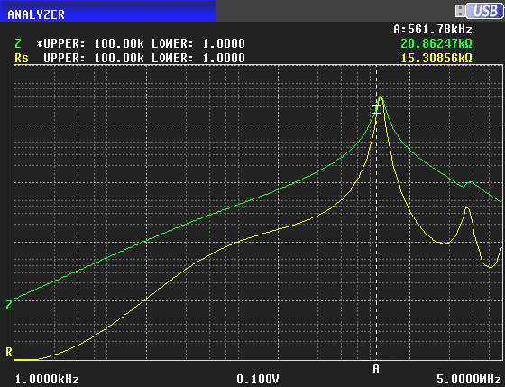

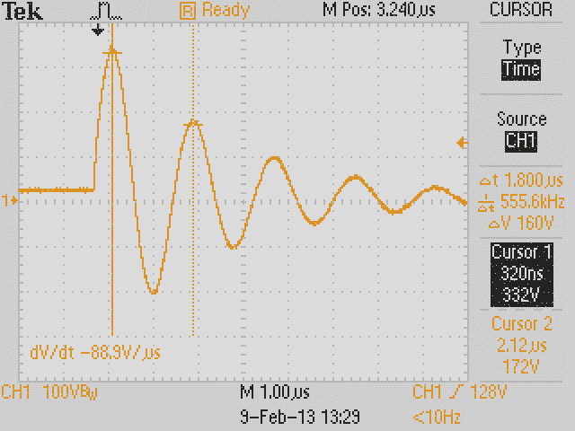

There is no certain answer to this. The only data available refers to energising the coil and not discharging it.
But you can make an educated guess about it. Assume that the demo needs to be impressive, so let's assume you have 1J stored. The energy stored is given by
W = l2L/2
With 10A flowing, that requires an L of 20mH.
Including the capacitances of the switch, neon and self capacity of the coil (the majority), would give a total C of around, say 100pF.
Two reactances will give a resonant frequency of
f =1/2π√LC
which gives around 100MHz and this means that the neon would strike at or before the first peak of oscillation, which would mean a time of around 2.5ns. I can't help thinking that the self capacitance would be greater than this - which would make the time correspondingly longer.
Once the neon has struck, everything changes, of course.
The value of the original R would be 1Ω. (10A 10V) and the time constant for this and the 20mH inductor would be L/R, which = 20ms.
Interesting to compare the two times involved - even if they are only back of fag packet calculations. Feel free to find gross errors in my arithmetic.

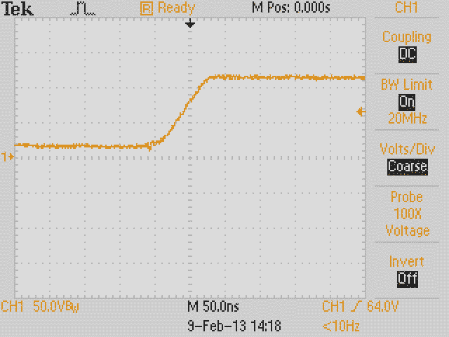

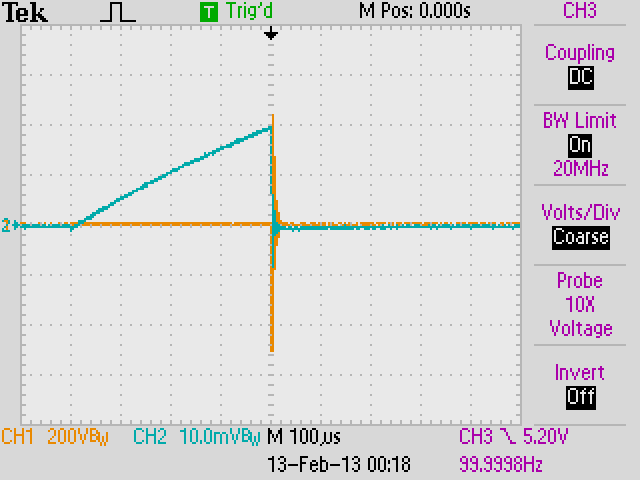

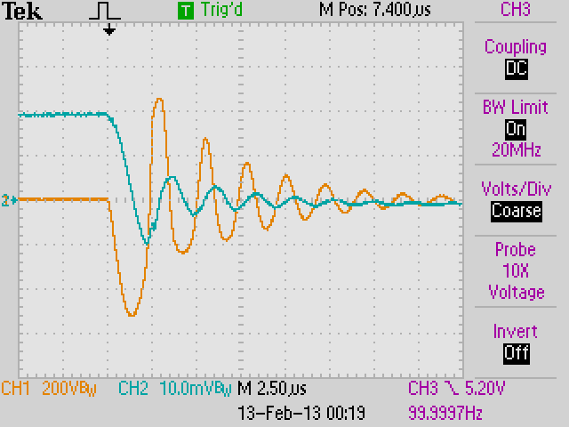

Here are some oscilloscope captures of the behavior of an inductor under circumstances similar to the one being discussed in this thread.
I used a 1.734 mH crossover inductor. It is an "air core" inductor, with a DC resistance of 1.82 ohms.
I connected it to a power supply adjusted to cause a current of 3 amps DC to flow in the inductor. I then disconnected the power supply and monitored the voltage across the inductor. There was no neon lamp involved, nor was anything else other than the 100x scope probe connected to the inductor. Here's the voltage across the inductor at the instant of disconnecting the power supply; the two cursors are used to measure the self resonance frequency of about 555 kHz. Even though there's nothing connected across the inductor and theoretically the voltage should rise to infinity, the distributed capacitance of the inductor limits the voltage rise:
I didn't have a neon lamp handy, so I connected an approximately 100 volt zener diode across the inductor, with the polarity arranged to clamp the inductor voltage when the power supply was disconnected. Here is the scope capture of that event:
This iimage shows the leading edge of the rising inductor voltage as it approaches the clamping voltage; we can see that the voltage rises at a rate such that it takes about 50 nS to reach about 100 volts.

Interesting. From your results (the frequency of the oscillation), I conclude that the self capacitance of the circuit must be around 200pF. This is not an inconsiderable capacitance.
Also, the Q of the circuit is round about 2 (Looking at the decay rate on the trace), so that makes the resistance around 1.5k at that frequency. Quite a bit higher than the DC value but not surprising as it's an audio frequency core.
I could always be wrong in my arithmetic but I checked it once or twice.
You've raised an issue that I wasn't going to mention because it's an additional complication to the factors being discussed.
This inductor I used was not the sort of thing one would use in a switcher. It's a multi-layer solenoid wound on a nylon bobbin with 20 gauge wire; it has 10 layers in fact.
This kind of construction leads to considerable proximity effect loss and the real part of the impedance increases dramatically at higher frequencies.
Here's a plot of the magnitude of the impedance (green) and the real part of the impedance (yellow):
The frequency we saw on the scope is the natural resonance frequency, not necessarily the frequency of maximum impedance, and it's lower than what the analyzer shows because of the additional capacitance of the scope probe, etc. Anyway, at the frequency of maximum impedance, the real part is almost 30k ohms.
So, of course, the resistance causing the damping of the free oscillations is not the DC resistance, but a much higher value AC resistance. I wasn't going to mention this. :wink:
