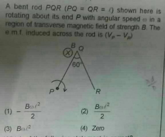

I am considering the two rods separately .Considering QP alone EMF induced will be (1/2)Bωl2 with Q at higher potential .
Considering QR alone EMF induced will be (1/2)Bωl2 with Q at higher potential .
This gives zero potential difference between P and R.
But this is incorrect .
What is the mistake ?
Why?
Consider six points, B, R, S..., arranged around P as corners of a hexagon. What is the potential difference between each and the next?

@haruspex , @Charles Link If I connect P and R with a rod/wire such that PQR is a complete loop , there would be no current in the loop . Right ?
So basically VP - VR = -(1/2)Bωl2 irrespective of whether there is an incomplete loop (like in the OP) or a complete triangular loop (like the modified setup in the above para ). Right ?

@Jahnavi I need a few minutes to work outt what the sign of the voltage is, etc., but this problem reminded me of a previous one that I looked up, because I remembered it as having the necessary concepts to determine the answer: https://www.physicsforums.com/threa...een-two-points-in-a-loop.943126/#post-5966332 See in particular post 9 of that thread. ## \\ ## And yes, I think you have this one correct. ## \\ ## And QR above has zero voltage, because you could draw an arc of a circle connection between Q and R that has is always at a distance ##r ## from P. The electric field ##\vec{ E}_{induced } ## would be perpendicular to the arc at any point, because ## \vec{v} ## is along the arc. (Using ## \vec{E}_{induced}=\vec{v} \times \vec{B} ##). This makes ## \int \vec{E}_{induced} \cdot d \vec{l}=0 ## because the dot product of ##\vec{E}_{induced} \cdot d \vec{l}=0 ## along that arc. (You arrived at that same conclusion by considering the voltage for the straight line path from points P to R).

Suppose we join P and R so that we have a triangular loop. There will be equal EMF's induced in PQ and PR . There will be no induced EMF in QR .
Is this situation equivalent to as if we had a battery of EMF E between P and Q with Q at positive potential of the battery . A battery of same EMF E between P and R with R at positive potential of battery . Q and R are connected by a plain connecting wire .
So , basically the loop of three rods (modified problem ) is equivalent to two batteries of equal EMF ( between PR and PQ) placed parallel to each other . Because of this no current flows between Q and R . Or , no current flows in the loop .
Is this correct ?

Yes, a battery is a source of EMF, and yes, you have it correct. :) ## \\ ## And when two equal voltage batteries are connected in parallel, no current flows between them.

Suppose we change the geometry of the triangular loop such that angle between PQ and QR is 90° instead of 60° as given in the OP . PQ = QR = l . PR =√2l
Now EMF induced between P and R will be Bωl2 with R at higher potential . EMF induced between P and Q will be (1/2)Bωl2 with Q at higher potential .
Now why is it that despite R being at higher potential than Q , no current flows between R and Q ?
Is it because , now there will also be an induced EMF between Q and R with R at higher potential ?
Now the situation is as if there is a battery of EMF E ( between P and Q) in series with battery of EMF E (between Q and R ) .The equivalent EMF being 2E .
Just like the previous case , now this battery of EMF 2E between P and R ( via Q) will be in parallel with a battery of EMF 2E ( directly between P and R ) .
Is this thinking okay ?

That is correct. The distance PR will be ## s=\sqrt{2} r ## making ## s^2 ## a factor of 2 in the formula for the voltage between P and R. The voltage QR is most easily computed in the way that you just did . An evaluation of ## \mathcal{E}_{QR}=\int\limits_{Q}^{R} E_{induced} \cdot dl ## would take a little work.

So basically while dealing with induced EMF's in a complete/incomplete loop we could think of the situation in terms of batteries in various parts of the loops .
If we traverse the loop starting a point and ending at the same point , all the batteries will be in series . If there is no net induced EMF in the loop , then net equivalent EMF of all the batteries (in series ) will be zero .
Right ?
