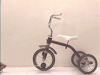

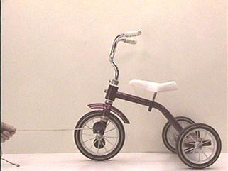

Will the bicycle move forward or backward?
We have 2 forces. The friction and the one we act on the wheel through the string. The weight and the normal force have torque equal to zero.
torque of the friction = T.r1
torque of the F = F.r2
In the second picture r1>r2, so the wheel will move backward, since in order for the wheel to move F=static friction
How am I doing so far? Am I in the right path, please?

For the first picture I, too, think there are 4 forces acting on the wheel but they are not the same as your 4:
  1. Weight of wheel itself acting vertically downward through axle and wheel/floor contact point.
  2. Contact force from floor.
  3. Tension in string acting horizontally, line of action R + r above floor.
  4. Force of axle acting on wheel, line of action unknown.
Must sleep now. It's the 4th force that's interesting; if the tricycle is accelerating forward (I'm sure it is, it's the analysis that's interesting) then it includes a horizontal component that is accelerating the mass of the tricycle and rotationally accelerating the rear wheels).
A further iteration (this is exploratory) ...

For the first picture how will we justify that the wheel is moving forward?
Won't we say that this happens because the torque of the tension is bigger?
For the second picture: Initially the wheel is moving backwards because the torque of the static friction is bigger. Then what?
I believe F in the figure is the force we act on the yo-yo, not the friction.
That's true, but I changed it to P and called the frictional force F.
The thing to understand is, always the wheel or the cycle will tend to move in the direction of the applied force.
So the wheel will move towards P in any case (transportational movement)
In my first picture it will rotate anticlockwise all the time.
In my second picture it will rotate clockwise at the beginning and then?
As the wheel rotates clockwise, the point of application of the force will shift (since you are pulling with a string tied to a fixed point on the wheel), until the torques balance so that there is no tendency of the wheel to rotate, and it will be simply dragged along.
The same thing will happen eventually in the first case too, because the point of application of the force will shift in both cases. Anyway, we are considering what will happen right at the beginning.

If the trike didn't exist (just the front wheel on it's own)
then the front wheel would definitely roll to the left.
because you would just be applying a torque from about 5cm above ground level
no different from pushing or pulling it form any other place really
- it moves left
If the trike is attached but completely frictionless
Then it only adds mass (inertia) to the centre of the front wheel
So, yes it always moves to the left
regardless of how much friction in the front tyre
- it can slip to the left if it pleases, I don't care.
