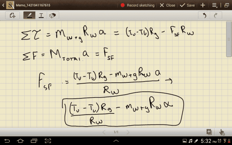

UMath1 said:
So I did that and this is what I got.

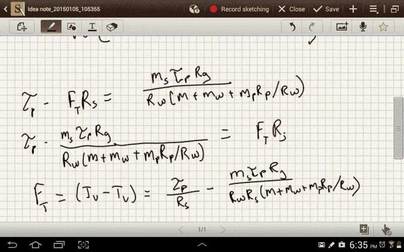

Can I simplify this more? Is there a way I can find the force of the chain solely in terms of the force of the pedal and their respective radii? And likewise, is there a way to find the force of static fricition solely in terms of the force of the chain on the rear gear and the radii of the wheel and rear gear?
When you ask about the force of the chain, are you referring to the force in the upper part of the chain, the force in the lower part of the chain, their difference, or their sum?
Chet
I mean the net force of the upper and lower tensions. Tu-Tl
UMath1 said:
The sum
The vector sum of the tensions in the upper and lower parts of the chain are determined mainly be the preloading of the chain. Prior to riding, the tensions in both sections of the chain are equal, and pulling forward on the rear wheel assembly and backward on the front pedal assembly. When the bike is accelerating, the tension in the upper part of the chain increases, while the tension in the lower part of the chain decreases. However, the lower part of the chain does not go into compression. So, during acceleration, the tensions in the two sections are still pointing in the same direction. In my judgement, the resultant force they impose on the rear wheel does not change significantly, nor does the resultant force they impose on the front pedal assembly. However, the moments that they impose on the rear wheel assembly and on the front pedal assembly change substantially. This is because of the difference in tension that develops between the upper portion of the chain and the lower portion.
Chet
Right. So, is there a way to calculate the difference in the two force based soley on the applied force on the pedal and the radii of the pedal and pedal sprocket? Similarly is a way to calculate the forcd of static friction soley based on this difference of the two tensions and the radii of the rear gear and rear wheel?
You already have that if you are willing to make the reasonable assumption that the rotational inertia of the pedal assembly is negligible.
You already have to equations necessary to determine that.

No, I thought the force the bike wheel applies on the ground could be obtained by a torque balance and hence the equation: (Tu-Tl)Rg/Rw. Then by Newtons 3rd Law the force static friction applies should be the same.
Right. The force of static friction on the bike's rear wheel is given by this formula. Draw a free body diagram for the bicycle as a whole. You have the value for the force from static friction acting at the rear wheel. What other external forces is the bicycle subject to?

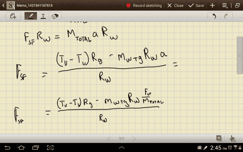

I must be missing something. You apply a torque to the pedal, and it causes a corresponding torque to be applied by the ground to the rear wheel (to accelerate the bike). You hold the torque on the pedal constant while the bike is accelerating, and the corresponding torque applied by the ground to the rear wheel stays constant. So, what's the problem?

UMath1 said:
In order for the wheel to rotationally accelerate the torque of the chain MUST be greater than the torque of static friction.
If you recall, we assumed that the wheel has negligible moment of inertia in order to simplify the calculations. Accordingly, it takes negligible net torque for it to accelerate.
If you want to re-do the calculations with a non-negligible moment of inertia in the rear wheel then we can do so.
UMath1 said:
In order for the wheel to rotationally accelerate the torque of the chain MUST be greater than the torque of static friction. Based on that equation the only way that can happen is if maximum static friction value is attained. Otherwise, static frictions torque would continue to match the torque of the chain, meaning no angular acceleration.
If the rotational inertia of the rear wheel is neglected, that equation tells you that the chain torque is equal to the static friction torque. If the rotational inertial of the rear wheel is not neglected, then the chain torque has to be a little higher than the static friction torque, but part of the chain torque is consumed in accelerating the rear wheel, so the static friction torque is the same.
