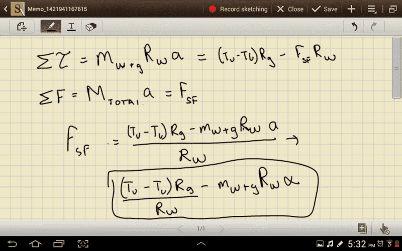

UMath1 said:
Ok so did thatView attachment 87477
I'm not sure what your last line represents, since it is not an equation.
The middle two lines are equations, each involving the same two unknowns, FSF and a. Decide which unknown you are interested in determining. If it is the frictional force, use one of your equations to replace a in the other equation.
The last line is a simplification of the middle line. Jbriggs444 was trying to help me eliminate "a" by using alpa=a/r. But I am not sure how to progress.
You could do worse than what I suggested in post #107. (107!)

UMath1 said:
Worse?
Perhaps English is not your first language?
Anyway, try what I suggested in post #107. I see Chet has already tried to help you through this. I don't understand why you are so reluctant to try it.
So I did try that.
But now I have staticfriction on both sides of the equation.
UMath1 said:
So I did try that.
It would be much friendlier if you could transcribe that equation.
##F_{sf} = \frac{(T_u - T_l)R_g - M_{w+g}R_w\frac{F_{sf}}{M_{total}}}{R_w}##
That equation looks complicated. But almost everything there is a constant. If you roll all of the constants together, the equation takes the general form:
##F_{sf} = k F_{sf} + c##
Could you solve that equation for ##F_{sf}##
UMath1 said:
Would I need to integrate both sides?
Huh? Try subtracting ##k F_{sf}## from both sides to start.
UMath1 said:
FSF=c/1-k
That is correct -- or would be if we fix up the notation slightly. When written on one line in text form, the conventional interpretation of what you have written would be to divide c by 1 and then subtract k. i.e.
##F_{sf} = \frac{c}{1} - k##
What you want is
##F_{sf} = \frac{c}{1-k}##
Which you would write on one line in text form as Fsf = c/(1-k).
Now you just have to go back to your original equation...
and perform the same manipulation you just did on the simplified version.
So it would be
FSF= [(Tu−Tl)Rg]/ [Rw(1+(Mw+g/RwMtotal))]
Correct?
