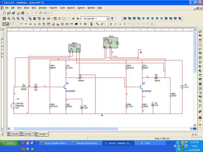

I have to design a multistage bjt pre amplifier with following conditions
gain 20-60dB
input impedence >= 5K ohm
output impedence <= 100 ohm
bandwidth 300Hz - 3MHz
source impedence 600 ohm
load impedence 10 K ohm
can someone please give me a good tutorial link which i can learn to design above pre amplifier?
thanks

well i drowned one according to your rules but it does not simulate well.
i can make this on vero board before pcb.
i need two stage bjt pre amp.but i don't know output impedence of first stage and input impedence of second age.
and how to set this upper frequency (3MHz) and lower freq (300Hz) 3db cut off
how to decide coupling capacitor values.
lot of problems
can you post a step by step procedure with relevant equations?
so i can design amp with that procedure.
thanks

You would need to remove C3 and C4. I know it drops the gain if you do this, but it makes the gain predictable and extends the bandwidth.
Then you can calculate the input Z of each stage and also the size of the capacitors. The reactance of the capacitors should be about 10% of the input Z of the next stage at the lowest frequency.
You will also need an emitter follower as the last stage to get that low output impedance.

ok what is the input impedence of second stage?
About 3000 ohms.
We have 3 resistors in parallel.
25400 ohms, 4700 ohms and (HFE times 100 ohms)
So that is 3966 ohms and something like 10000 ohms if HFE is 100.
That 4.7 k needs to go. Calculate a single bias resistor to give the base current.
The capacitors are also too small. More like 2 uF would be better.

no no, what i meant is what should be the input impedence of second stage if i want to designit irrespective to cct above posted
and what is that
HFE times 100 ?
and sholudnt we consider rpi of 2nd transistor

finally came up with this
:smile:
circuit tested(built on a PCB) and working
Excellent .
What is the 6.2 pF for?
What bandwidth do you get with that 6K load?
vk6kro said:
Excellent .
What bandwidth do yu get with that 6K load?
6.2pf is to set upper cutoff point
