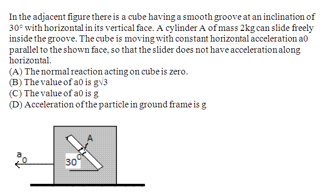

Diagram of a cube with a smooth inclined groove on its vertical face at 30 degrees to the horizontal, with a cylinder A in the groove and an arrow a0 pointing left along the base.
Working from the reference frame of block , a pseudo force Ma0 towards right need to be applied on the cylinder .
Forces acting on the cylinder are pseudo force , weight Mg and normal force from the block (if any) .
Since the cylinder does not have horizontal acceleration , N sin30° = Ma0 .
I am not able to proceed from here .
Any help would be appreciated .

The cylinder does not have horizontal acceleration in the rest frame of reference. So it accelerates with respect to the slope.
Sorry , i did not understand . Could you please explain it a bit more . Do you think the application of pseudo force and subsequent equation written in the block frame are wrong ?
You assumed that the horizontal acceleration of the cylinder is zero in the block frame of reference, didn't you?
Yes .
So , should the equation be Ma0 - N sin30° = Ma ( 'a' is the horizontal acceleration of the cylinder in the block frame ) ?
If the cylinder does not accelerate horizontally with respect to the block, what is its (horizontal) acceleration with respect to the ground?
I guess you wanted to ask the other way round :smile: .
Anyways , (horizontal) acceleration with respect to the block would be a0 . That would give N = 0 .
Now ,how should I calculate value of a0 ?
What is the vertical acceleration? There is some geometric relation between the horizontal and vertical acceleration of the block in the grove.
