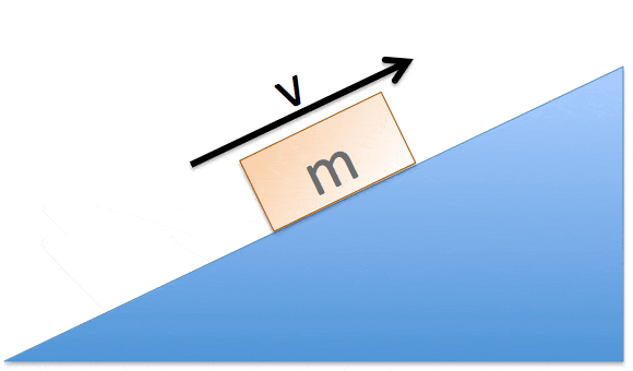

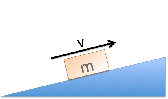

Consider the following two scenarios with the same box sliding up two differently inclined ramps. The coefficient of static friction is 0.7, the coefficient of kinetic friction 0.5. Eventually, the box will stop. Up to what maximum angle of the incline (in degrees) would it not slide back down?

I KNOW! but I'm on the last question and this unit has been confusing and torturous I just want it to end :(
I first though that the reverent equations would be the kinetic friction and the static friction equation but then that doesn't really matter because there are no number

Fg = 9.8m
Fn= (9.8m)cos(theta)
Fk= (9.8m)cos(theta) * .5
Fst= (9.8m)cos(theta) * .7
would these be right?

so the force of static friction is only on an object while it is not in motion, the force acted upon an object needs to be greater than this static friction in order for it to move. What does Newtons second law equation say?
mass*acceleration = sum of forces
good. when the object is not moving what is the force?
zero
Yes that is good, so sum up all the forces in the x direction, and keep in mind that m*a = 0 when the object is not in motion.
Fg +Fn = 0
9.8m +(9.8m)cos(theta)= 0
cos(theta) = 1 ?
Not exactly, you don't add the normal force, and you haven't incorporated static friction yet. Also you can't just add mg to the forces in the x direction, because mg is neither in the x nor y direction with respect to the surface of the plane, you have to work with components.

ok so think about it like a triangle, the force collinear to the plane is Fgx, and the force orthogonal is Fgy, and Fn = Fgy.
okay so fgy = 9.8mcos(theta) and fgx = 9.8msintheta)
correct, ok so now that you know that, sum up all the forces in the x direction again.

the forces in the x direction are fgx and fst
9.8msin(theta) + (9.8m)cos(theta) * .7
  • #32
fgx and fst are opposing forces, when you say "sum up the forces" you don't add the magnitudes. You have to set one direction to be positive and the other negative, so when they oppose forces one is negatively acting on the object and the other is positively acting on the object.
  • #33
this is sooo confusing! thank you soooooo much for helping me !
so would it be 9.8msin(theta) - (9.8m)cos(theta) * .7
  • #34
yes it would be, now that you know what the sum of forces is recall what they are equal to from post 19-20.
  • #35
9.8msin(theta) - (9.8m)cos(theta) * .7 = 0
9.8msin(theta) = (9.8m)cos(theta) * .7
9.8msin(theta) /(9.8m)cos(theta)= .7
sin(theta)/cos(theta) =.7
tan(theta) = .7
