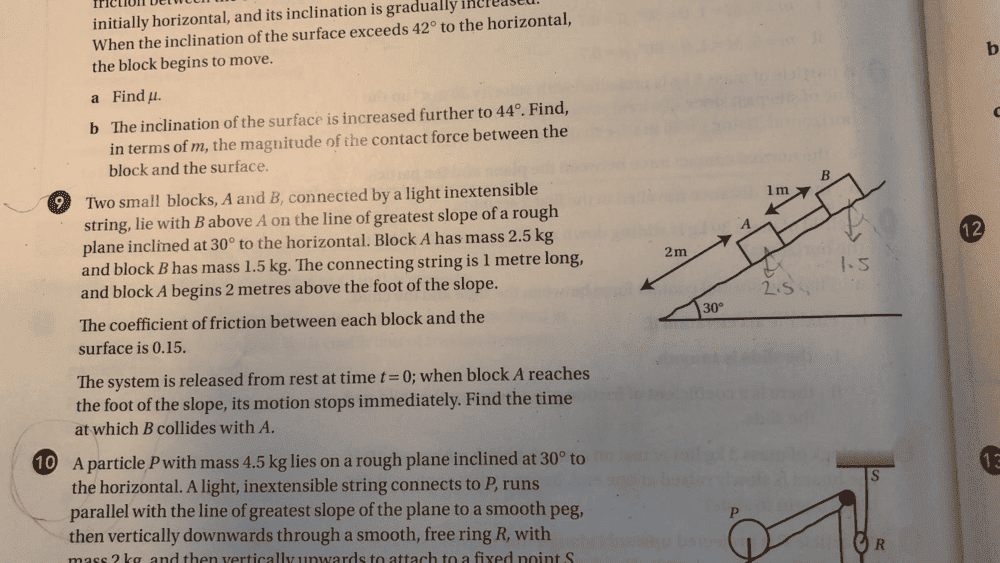

Here is the question (Qu 9):
241861
Here is what I have attempted:
assumed that the accelerations are equal, found a value for the acceleration, thus worked out the time taken for A to reach the bottom.
then assumed that the tension becomes 0 once A hits the floor, and then worked out B's new acceleration and hence the time taken for B to hit A.
How am I allowed to assume that the acceleration is equal?
How do we know that B does not at any point move slightly faster such that the string becomes "squashed"?
I get the answer 1.29, which according to the answers is incorrect.
You don't need to assume anything. Just find the acceleration of each block as if the other one were not there. Are the expressions equal or not?
If the blocks start from rest and their accelerations are equal, can this happen?
