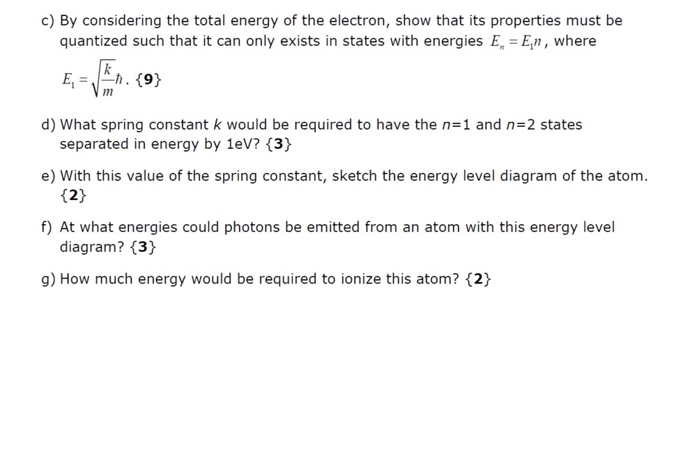

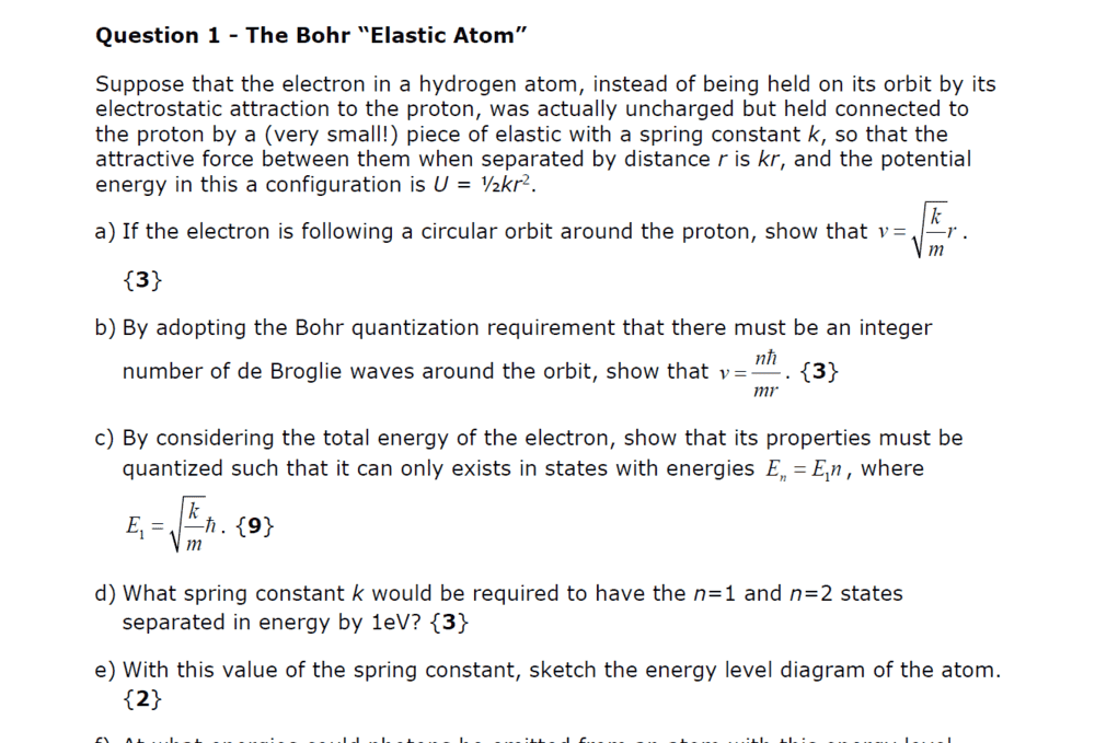

Help with parts (c) and (e)
Given in the screenshot
Hello folks,
I've managed questions (a) and (b) but don't get what to do with part (c). Normally you would equate the velocity equations v2=e2/4πεmr=(n2h2)/(m2r2 ). This let's you isolate the radius and use it to calculate En. But I can't see how you could do this for v given in (a) and (b).
Also, part (e). If En = E1n then the energy levels simply scale linearly ... that can't be right?
Okay. I managed to solve part (c) by isolating r2.
But part (e) is still unclear ...
Remember, this is not a "real"atom where electric force acts between the proton and electron. You derived that En = Ein .Are those energy levels equidistant?
They would be linear (equidistant) and positive - i.e. n=1 is 1eV; n=2 is 2eV; n=3 is 3eV ... is that correct?
But wouldn't n = ∞ need to be 0eV?
It makes the remaining parts of the question (f) and (g) very confusing:
Clearly this is ludicrous ... help!
Yes.
The choice of zero of energy is arbitrary. For the hydrogen atom, the ionization limit (separated particles) is often chosen as the 0, but this is arbitrary. One could also take the ground state to be 0.
Okay ... so for question (f), could photons not be emitted for any energy multiple of E1? And how would the ionisation energy be determined?
Yes.
How is it determined for the hydrogen atom?
The lowest energy level, n=1 at E1 is given as 1.0 eV ... so that would be the ionisation energy?
DrClaude said:
Yes.
But this doesn't seem to make sense for a 3 mark question ...
No. Again, how is the ionization energy calculated in hydrogen?
I'm not responsible the grading scheme :smile:. I guess some explanation is expected.
Ionisation works by removing an electron from it's most outer bound shell ... but if the energy is increasing as En=E1n then essentially you're saying you can't remove the electron ... ?
As far as I understand ionization energy, it depends on which state the electron is in.
You're almost there, so I'll give you the answer. The ionization energy is the difference in energy between the last bound state and the ground state. Here, you have
\lim_{n\rightarrow \infty} E_n = \infty
so it is impossible to remove the electron.
By the way, you are basically creating a model for the harmonic oscillator, which indeed has no limit in energy for bound states.
