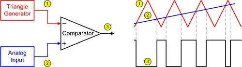

I'm looking into the design of the control circuit for the mosfet. If I know the output voltage and input voltage then I can find the duty cycle required. I found this schematic that uses feedback
Source
https://www.maximintegrated.com/en/app-notes/index.mvp/id/2031
Why would I need feedback that changes the duty cycle like above ?, if the output voltage is dependent on the duty cycle and Vin and if those are fixed values then Vout should be constant regardless of load ?, also I'm a bit confused on the working of the above schematic, is it trying to maintain Verror of 0V regardless of changes in Vout ?
What makes you think that the Vin would be fixed? This is not often the case. There are other things that will cause the output voltage to droop when a load is applied also. You are thinking it backwards concerning the output voltage and the Verror. Verror does whatever it has to in order for the inverting and noninverting inputs of the opamp to remain virtually the same. This is a basic rule in opamp analysis. So if the reference is stable, can you see how the rest of the circuit will behave?
DC to DC converters behaves just like a ideal "DC" transformer. And for the boost converter n = Vout/Vin = 1/(1 - D) but this is true only when the inductor is working in continuous conduction mode (CCM), the inductor current never reaches 0A. And all component are ideal also Vin is kept constant.
And because we are living in non ideal world we need to change duty cycle to kept Vout at fixed value.

So basically Vref would be the max boost converter output voltage or voltage you are trying to maintain. So if for example we are trying to maintain 10V on the output and Vout drops to 9.7V then Verror is 10V-9.7V = 0.3V. If Verror increases then the duty cycle decreases. But if the voltage decreases then the duty cycle should increase since Vout = Vin/(1-D) ?

If Vout drops the voltage at Verror will rise, this means that as long as Verror > Vramp the voltage at Vswitch is high so the duty cycle increase.
