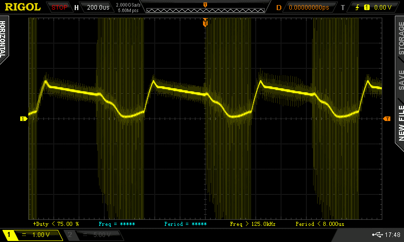

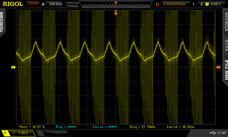

If i put a 50Ω load at full voltage it would whine with a clean high sound, and the gate would get a regular missed pulse (first attach).
If i get it into constant current at 2A, then it starts making a much lower tone with some surging, but similar picture of bursts of pulses at semi-regular intervals (second attachment).

  • Oscilloscope screenshot of a PWM gate signal, yellow trace alternating between high and low levels with irregular missed pulses, +Duty 42.86%, Freq 357.1kHz, Period 2.800us, 5.00V/div, 10.00us/div.
  • Oscilloscope screen capture of a gate or switching waveform, with pulse bursts clustered in groups and a long idle low segment; trace in yellow, measurement readout shows Freq = 147.0 kHz and Period = 6.800 us.

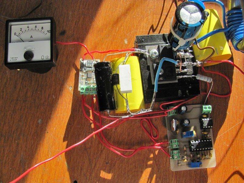

Overview of the build attached.
I don't see any obvious current loops to interfere with the sensing.

  • Photo of a breadboard-style boost converter build on a wooden table: a black heatsink with mounted transistors and diodes, a yellow capacitor, a blue-wired inductor coil, a resistor, and a small green-terminal control board at the bottom edge.
  • Breadboard-style build of a boost converter on a wooden bench: a panel ammeter, a blue toroidal inductor, a blue electrolytic capacitor, a small control circuit board, and a battery holder with four 2500 mAh AA cells.

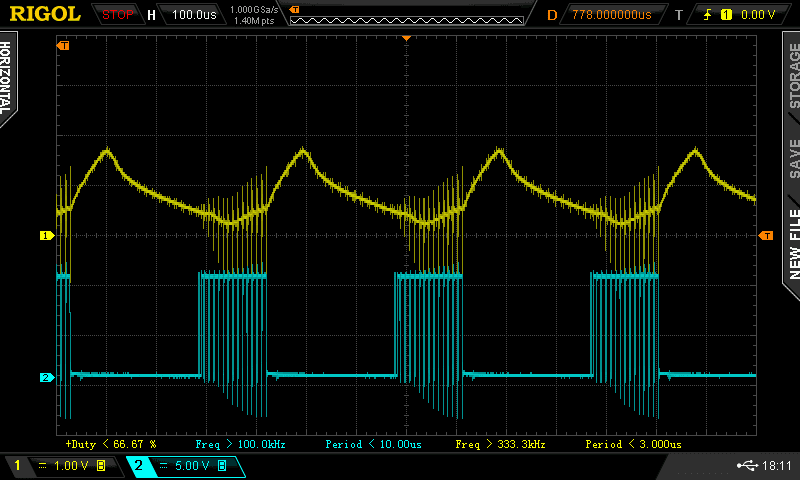

Here is what i see across the current sense resistor (with 10nF capacitor at the input), with the arc lamp and current set to 5A (0.5V on the amp input).
I think it sort of averages to 0.5A, but it does not look good at all, and DC meter shows 8-9A.
So, no whine does not equal no problem...
  • Oscilloscope screenshot of a periodic voltage waveform across a current sense resistor, showing repeated decaying pulses with sharp spikes and ringing between them, at 1.00 V per division, 20 microseconds per division.

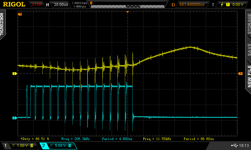

you need to first fix the instability issues with resistive loads.
second that.
Your current feedback voltage looks as if the lamp fires every 60 microseconds
current reaches a 20 amp peak then decays to near zero on ~25-30 μsec time constant
and the 494 doesn't pulse again until current goes below 5 amps
control theory says feedback needs to be faster than the process
but yours is instantaneous
if you can risk blowing up a lamp
or try it with a 2 ohm resistor load
insert a little bit of RC delay in series with pin 16
perhaps 100 microsecond time constant for starters
so that the poor little 494 is responding to time average of its last several cycles, not the instantaneous current
things should get either much better or much worse.
but you'll learn something. And if you post another photo, so will I.

Eventually, i got sick of the thing picking up everything from it's own switching noise to hand waves over the wires to apparently a local radio station (or some other audio source).
So i decided to murder that problem with as much overkill as i had on hand.
MAX4080T current sense amplifier, small 0.01 Ω sense resistor, high side sensing, no sense ground loops, clear low impedance feedback signal.
Here is the appearance now:
Photo of a homemade boost converter on a wooden table: a panel-mount analog ammeter scaled 0 to 10 A, yellow capacitors, a black heatsink with MOSFET, a blue inductor coil, red and blue wires, and a small green-terminal PCB with an IC.
Got the signal filtered with 100Ω by 0.1uF RC filter, and it looks quite clean now.
But it does not work at all, and now i can see the anomaly cleanly.
The feedback is backwards, for some time at least.

The current limit is set to 1V, here is what i get:
Oscilloscope screenshot of a repeating yellow waveform on channel 1 with a noisy trace, showing a sawtooth-like pattern with sharp rising edges and sloped decays, timebase 200us, sampling 2.000GS/s.
At first i thought it was due to too much output capacitance, somehow.
So, down to 30uF:
Oscilloscope screen showing a yellow waveform with periodic peaks and dense vertical switching bursts, with the status bar reading +Duty < 16.67 %, Freq 27.78kHz, Period 36.00us.
See anything strange?
Let me add the duty cycle on the second channel.
The limit is 0.5V here and below.
Oscilloscope screenshot showing a yellow trace with a sawtooth-like waveform peaking near 1 V and a blue PWM gate signal with bursts of narrow pulses; measurements read +Duty 66.67%, Freq 100.0kHz, Period 10.00us, Freq 333.3kHz, Period 3.000us.
The current is growing when DC goes down, for some time.
The current is decreasing as DC increase.
Oscilloscope screenshot: yellow trace (channel 1) shows a noisy line that rises to a peak then falls; cyan trace (channel 2) shows a pulse train of spikes ending abruptly. Readout: duty 66.51%, freq 208.3kHz, period 4.800us.
It seems that a change in duty cycle results in a momentary change of current in opposite direction.
Then it starts to follow the duty cycle, but by that time it's already far over or under the setting.
No wonder it's oscillating like crazy...
What is causing this?
Note how rapidly the current starts to climb, and compare with the rate of climb between the cycles when the DC is high.
As far as i can visualize it, it's the inductor getting charged and discharged - with the DC down to 0 it starts to discharge all the current in it into the load, with duty cycle starting to increase it's getting charged while the load runs on capacitors.
Does that sound plausible?
