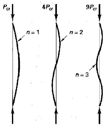

Well, you did ask how to calculate the mode shape in your OP.
Buckling mode shapes are technically not the same thing as vibrational mode shapes. The former are the different ways in which a structure will become unstable while the latter are the different ways that a structure will move dynamically, although they both might be mathematically the same in some simple cases. For example, here are the first three mode shapes for buckling of a pin-pinned column:
These would be the same as the first three vibrational mode shapes.
Regardless, I think the approach I described previously is the easiest and the most general. There may be an exact mathematical solution but I think it would be more complicated. You might be able to find where someone has gone through this and posted a solution already.
