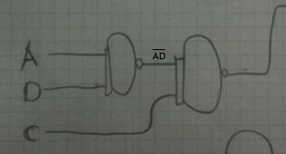

Building a circuit from NAND gates does require a lot of gates.But shouldn't each NAND gate have exactly 2 inputs?
Like this:
And you appear to have drawn a thin rectangle before each NAND gate.
What does that represent?
Did you perhaps intend something like:
Since this is the way to construct a NOT gate from a NAND gate.
Let's zoom in on the second sets of inputs for a minute:
The first NAND gate has the output ##\overline{AD}##.
And the second NAND gate has the output ##\overline{\overline{AD} C} = AD + \overline{C}##.Is that what you intended?
Or did you really want ##A\overline{C}D=AD\overline{C}##?

3 input NAND Gates are allowed and often used. Unless the question specified using 2-input gates, but it doesn't appear so.
Yes, Quabache is right we're allowed to use 3 inputs, though 1 input probably not...
You're right-- I'm not sure where I've seen it, but I can see that you're right (as per usual), that's not the sign for a NAND gate.
I intended to try and get the answer for the question but if there's a + C then I made a mistake it appears. What I really wanted is what you wrote at the end of that post. Is it all about just trying to build it via experience or is it about building a truth table and doing it methodically and schematically in a straightforward fashion?

Whatever works for you.
Systematic and methodical is good. :)On the wiki page for NAND logic, they give a couple of building blocks to create the various logic operations:
http://en.wikipedia.org/wiki/NAND_logic
With it you can build up your schematic.
Myself I like to work backward as follows.
You know you want to end up with ##AD\overline{C}##.
Last thing in a NAND gate is the NOT.
So before the NOT, you want to have ##\overline{AD\overline{C}}=\overline{AD} + C##.
But you can't make an OR directly from an NAND gate, so first you would use a NAND as a NOT gate.
Working backward you would have the 3 inputs ##A##, ##D##, and ##\overline{C}## for a first NAND gate, followed by the NOT construction.
You're left with only constructing ##\overline{C}## and I think you already know how. ;)

But that's the question. Is there another method, or is this all about trial and error?
Yes, thanks, I've used a similar page trying to do this :) I'll give it another go
I have the impression you were following a proper method.
Verifying your result showed a little mistake however. ;)
I'm sure you'll get it.

Method looks right.
Femme_physics said:
I understand what you mean-- and I think I got it
Very good! You got it!
And very creative to put a double bar over it and break it up! :smile:
I also like how clearly you explained what you did and how you showed a nice simple solution.
This time around there appear to be no beetles scurrying away. ;)
LOL
Thanks for the help ILS, everyon. Glad I got it right.
