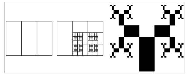

A DIN A4 sheet is divided into thirds. A rectangle is the root of the tree, the other two rectangles are each divided into thirds again. Two rectangles form the branches - one to the left, one to the right - the others are again divided into thirds and so on.
I want to calculate the area of that tree. I understood the mathod as follows:
First we have the whole sheet.
Then we divide it into three parts.
Then all except of $2^0=1$ part are again divided into three parts.
Then all except of $2^1=2$ parts again again divided into three parts.
Then all except of $2^2=4$ parts again again divided into three parts.
and so on I mean something like that:
View attachment 8106 So at level i of the tree we divide all parts except of $2^i$ into three parts. Have I undersood that correctly? (Wondering)
How can we calculate the area? Do we maybe have to write the above as a recursive function? (Wondering)

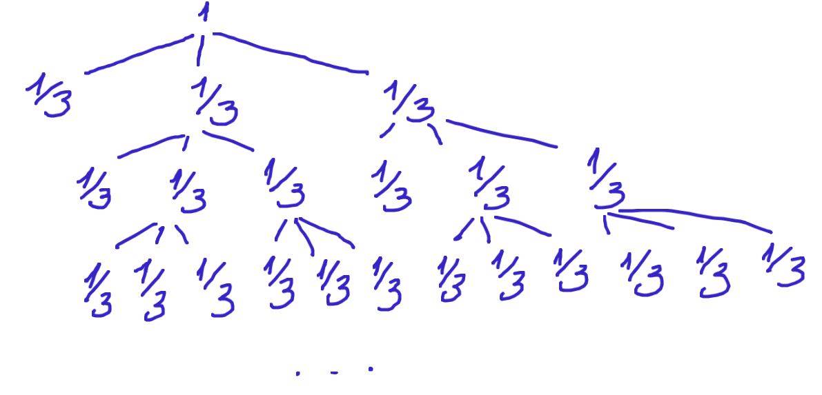

I'm a bit confused.
If we follow the algorithm in the first 2 pictures, we won't get the tree in the 3rd picture will we?
Can you clarify? (Wondering)

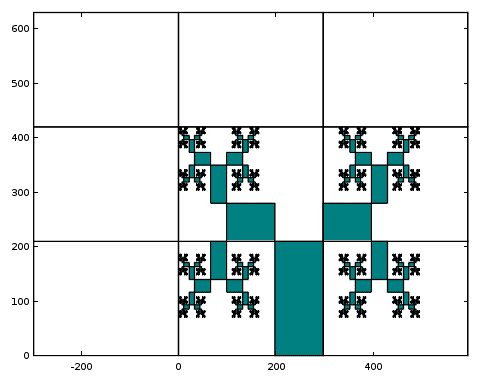

Hmm... if I understand correctly, and looking at the final tree, it works like this.
Let w=297mm and h=210mm.
Then the trunk seems to have width w/9 and height h/3, doesn't it?
And then we have 2 branches that each have width w/9 and height h/9, yes?
Those fork into 4 branches that each have width w/27 and height h/9.
Is that how it works? (Wondering)

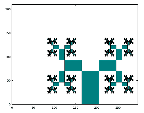

Is it like this? (Wondering)
Units are in millimeters and a DIN A4 is 297 mm x 210 mm.
Yes! Looking at that picture, do we have the following?
Let $S_n$ be the area of the rectangular at the $n$-th step.
From each rectangullar of area $S_n$ we get two new rectangulars with total area $\frac{2}{3}\cdot S_n$, i.e. each has area $\frac{1}{3}\cdot S_n$.
This holds because each rectangular gets into three pieces, and two of the three pieces are the branches of the rectanglar.
Let $S_0$ be the area of the DIN A4 sheet. Then $S_1=\frac{1}{3}\cdot S_0$, is the area of the one of the three pieces, which is the root of the tree.
The area of the tree is then equal to
$$S_1+\frac{2}{3}\cdot S_1+\left (\frac{2}{3}\right )^2\cdot S_1+\left (\frac{2}{3}\right )^3\cdot S_1+\ldots=\sum_{i=0}^{\infty}\left (\frac{2}{3}\right )^i\cdot S_1$$Is this correct? Or haven't understood correctly the idea? (Wondering)

All correct. (Nod)
It's just that if the whole tree is supposed to fit on an A4, that the trunk must be a rectangle with area $\frac 19\cdot \frac 13 \cdot S_0=\frac 1{27}S_0$.
That is what I have drawn and what seemed to match with picture 2 in the OP.
Or is the tree supposed to grow bigger than an A4? (Wondering)

I was looking at picture 2 and tried to find the trunk in there.
The best I could find is the rectangle at the bottom with 1/9th of the width and 1/3rd of the height... (Thinking)
Hmm... rereading the OP, it seems intended that after the initial division into 3 rectangles, one of those rectangles is supposed to be the trunk rectangle. That would then be the rightmost triangle. That would also match the scale in which the 3rd picture is drawn. And it means the tree grows bigger than an A4.
If so, then your justifications are perfect!
It just means that the 2nd picture is misleading. (Crying)

Then we have the following:
The area of a DIN A4 sheet is equal to $S_0=297\, mm \times 210\, mm=62370 \,mm^2$.
The area of the tree is equal to \begin{equation*}\sum_{i=0}^{\infty}\left (\frac{2}{3}\right )^i\cdot S_1=3\cdot S_1=3\cdot \frac{1}{3}\cdot S_0=S_0=62370\, mm^2\end{equation*}
So the tree has the same area as the sheet, hasn't it? (Wondering)
